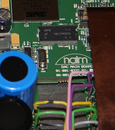

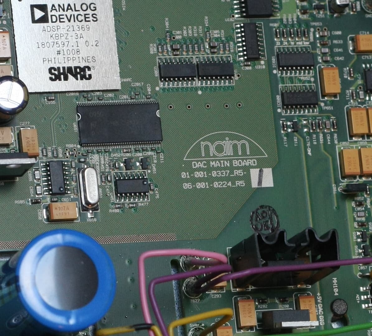

I have a rev 5 ndac. There is no way a Rev 2 dac could be modified to a Rev 5.

Btw, how do you tell the version of an ndac?

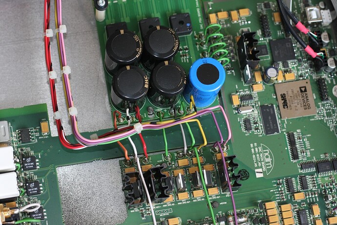

You’ll have to take the top off.
The obvious difference in Rev 5 compaired to Rev 2, is the SPDIF input PCB is part of the main board. Rev 2 has a ribbon cable connecting the PCB’s.
The circuitary around the SPDIF inputs on Rev 5 has more components.
