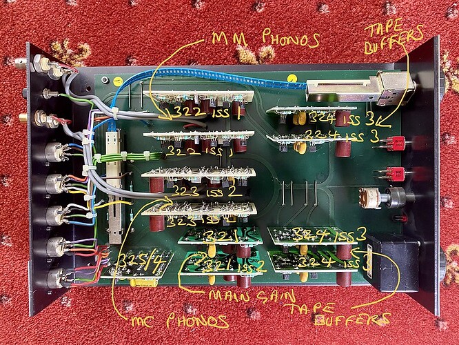

Hi I am new to forum, can anyone help from where can i order this nac 32.5 325/4 used or new online?
it messed up i cant find it anywhere online, any help will be highly appreciated. Thanks
Welcome to the forum. Short of having your Naim dealer ask the factory whether there are any spare boards still left at the factory, your best bet would be to ring round some of the longer standing dealers and see whether they have an old 325 board (switching relay, switch-on output delay) going spare. Otherwise it’s a case of keeping eye out on sites such as eBay and the like.
