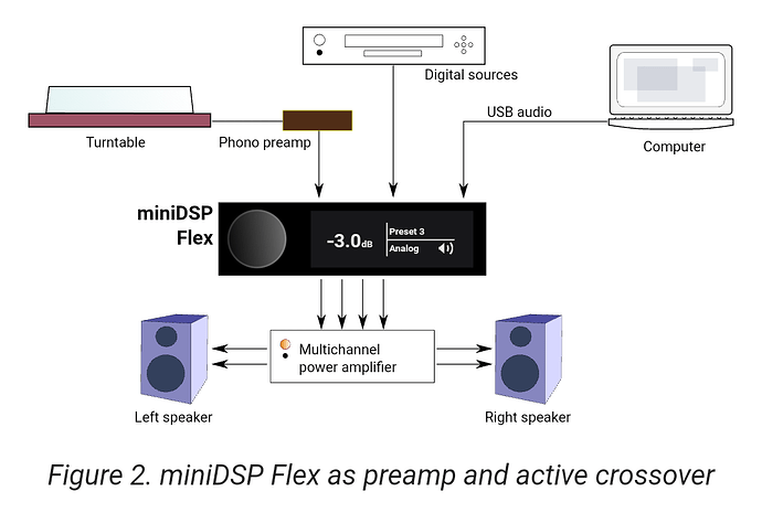

Interesting about the miniDSP. Any negatives on is, does it take anything away? Just had a quick look, is the config something like this, using the miniDSP asa a preamp for digital sources?

I don’t use it that way.
I connect the main outputs of the 272 to the 300DR (and then to the main speakers), and the phono L&R to the miniDSP (using shortish 1m cables!). This way the miniDSP only processes the signal for the sub. It acts as the crossover for the sub, combines L&R chanels into a mono sub signal and applies room correction for the sub only. This way it leaves the more delicate midrange and HF signals unmolested by the DSP and hence it doesn’t take anything away.
