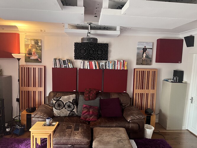

I must say room treatment is phenomenal - no way am I joking and I will attach pictures to illustrate.
The grey rectangles are called Soffits and I have them range limited. These absorb room mode and standing waves, wow, after that… what the low frequencies mask become revealed, the sound opens up with detail and decay even with high frequency tracks like Four Seasons and that artist who sings Angels (after Smashing Pumpkins guy dying).
Then.. adding the Alphas with slats by seating position- the clarity of high frequencies click. Honestly guys to get your sound as the recording engineer intends, your room needs treatment - but judiciously!

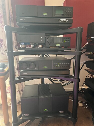

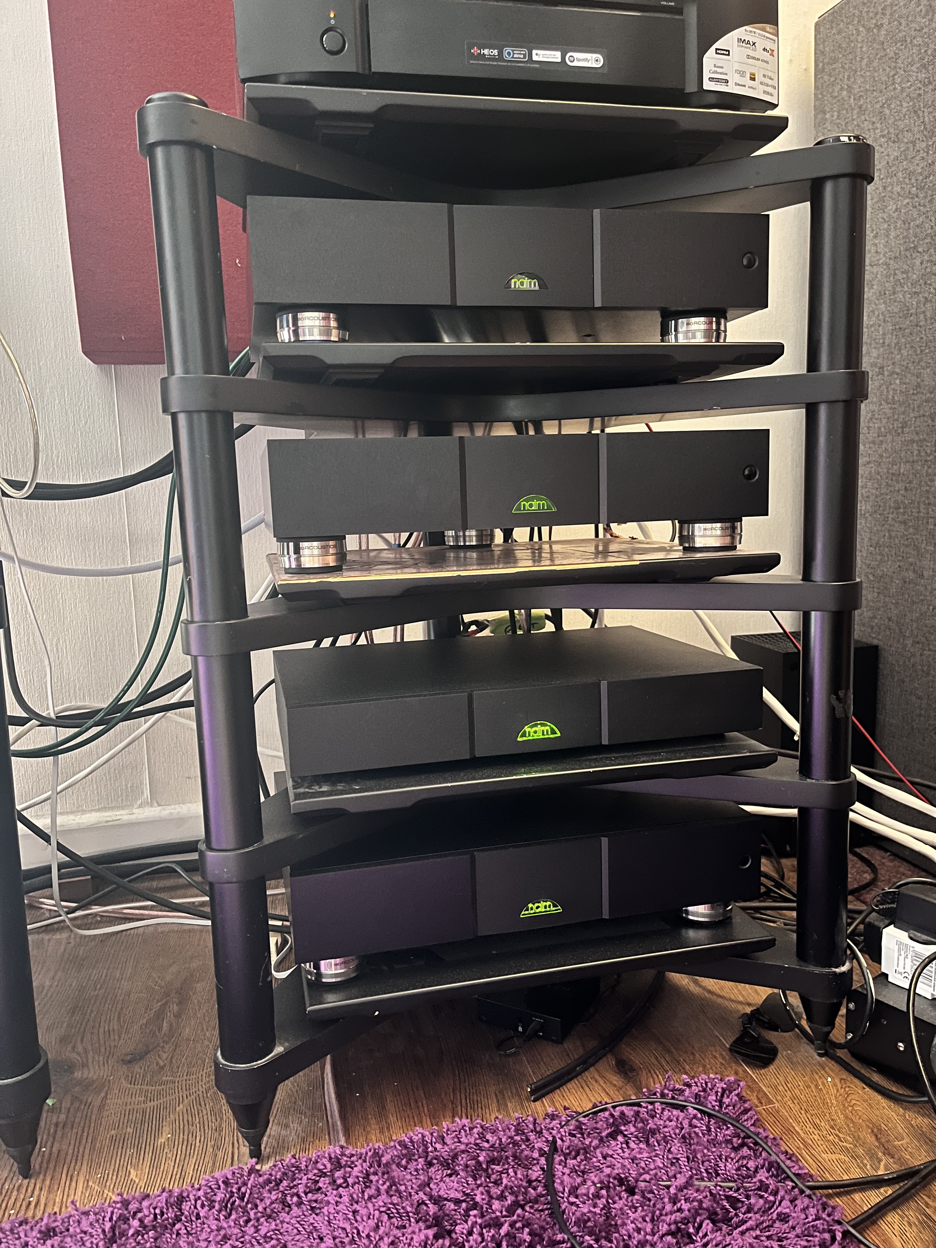

Also, on a much cheaper point, I know many more do this, isolation pods under components. I’ll picture that too.

According to your photos your cable treatments could use some attention to help the sound and aesthetics.
If that’s judicious I hate to think what going the full Monty would look like. It’s fine if you have a dedicated listening room and want to get the best from your system, but in a normal living room it would look ridiculous.

And talking of silly, I tried some IsoAcoustics once and all they achieved was to make the sound shrill and etched. Natural it wasn’t. Naim go to great lengths to design their equipment to work as one, and that includes the isolating feet. While the IsoAcoustics may change the sound for better or worse, one thing they certainly do is make the Naim equipment look very silly indeed, tottering in the air like overfed pugs.
If you could hide the hole in the roof and put off the black central panel, it would look much better I feel.

I’m absolutely dedicated to high end music reproduction but I look at your room and can’t help but think, as others are beginning to note, that the only reason room treatment has had a profound impact for you is that other aspects are, to put it politely, not where they should be.

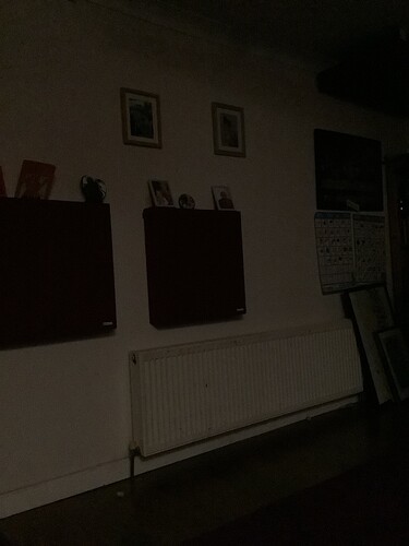

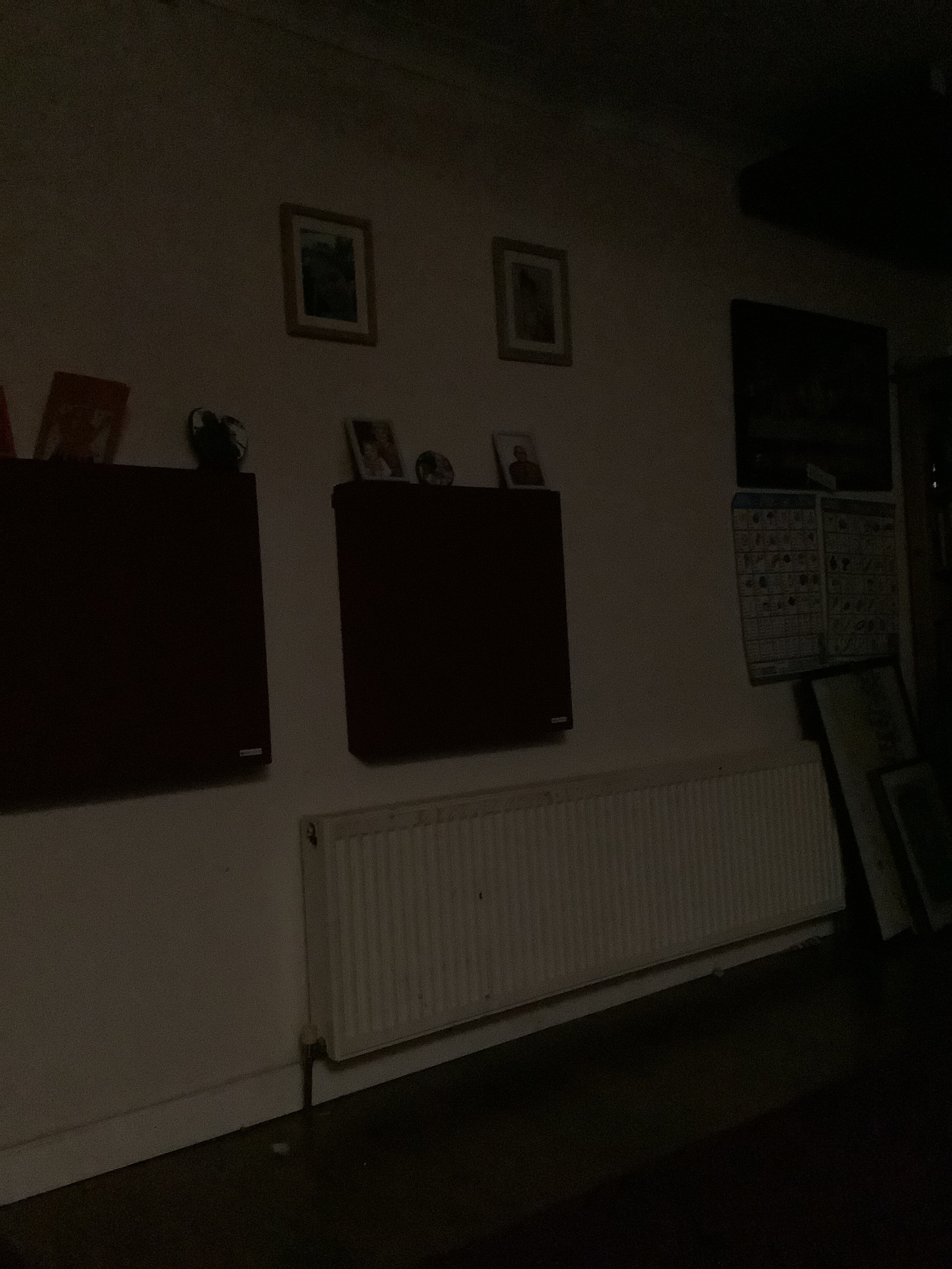

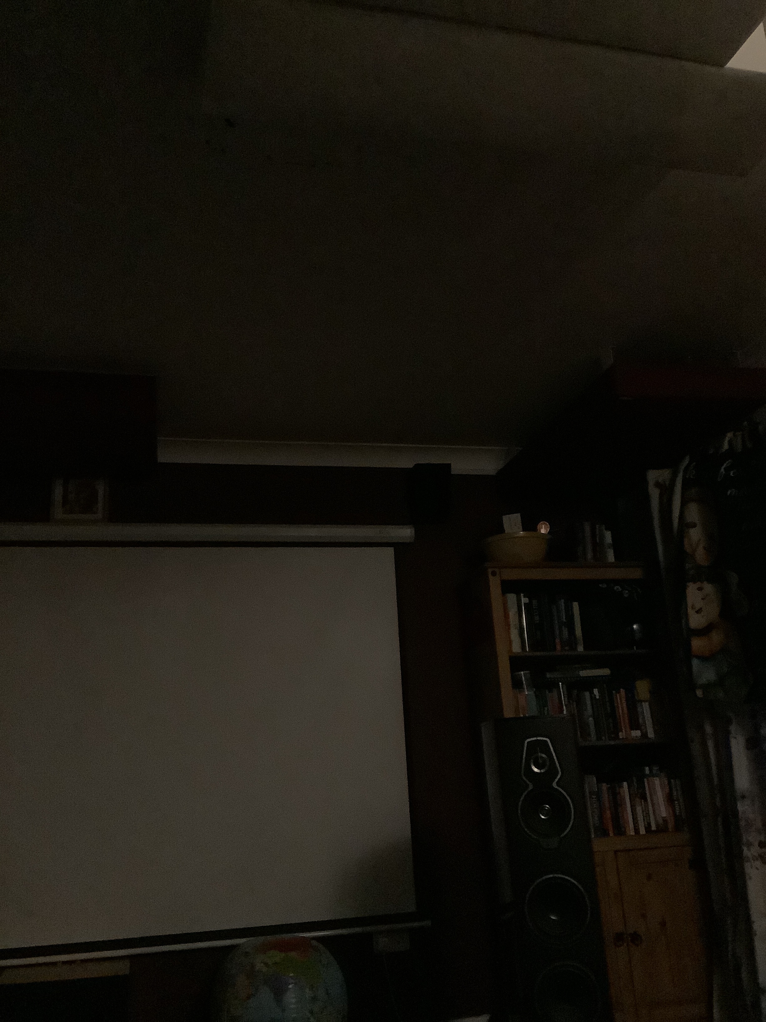

Yes the first reflections side walls and ceiling hsve all been addressed, I will attach a couple more pictures. The last thing I am going to do is put the right 244 full range above the left (making the first reflection far speaker twice the size) and putting a 100mm 1d Alpha 60 cm by 120 cm on this first reflection near speaker.

PS it is judicious, because I messed up with foam originally- to my partners chagrin as getting off foam glue is where I procrastinate! The height of the rear wall Alphas was also a key alteration, as being on the same level of the black Gothams interfered horizontal diffusion, ths sound became clearer but the sound stage width truncated.

Also, doing room treatment in a lounge situation is very tricky to get the aesthetic just right and to your liking. If I may say so, to my eyes, given your previously reported starting position you have done a fantastic job!
Personally, I always had a problem with what the GIK Acoustics cloud mounts do to the perceived ‘height’ of a treated ceiling. Recognising of course that the velocity trap technology needs the gap to work more effectively at low frequencies. But in my own case - a dedicated media room - I simply could not accept the reduction in height - and as a result have suffered the acoustic consequences!

Naim gears if setup right, given full stack of hi end products, it should sound very natural and balanced, that ‘LFs mask’ shouldn’t happen.
As HH said Naim gears are very sensitive to what they sit on, and the feet are part of the sound. Now seeing all those Isoacoustics feet and platform I could imagine the Naim sound has substantially changed, and no bass! – based on my previous experience with Iso.
