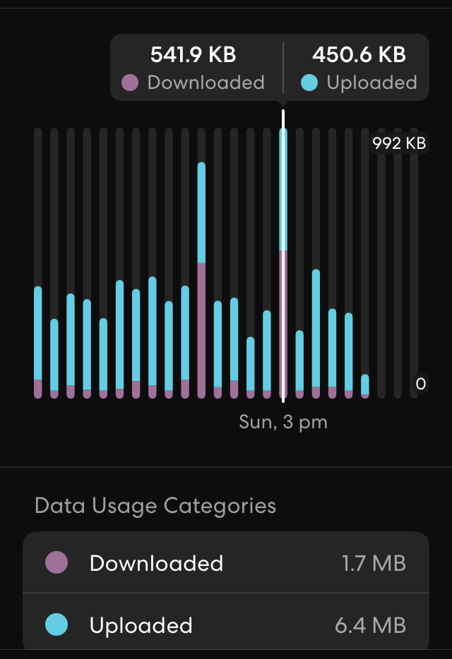

My Eero router has a great feature where you can actually see the data being transferred to/from all the devices. However I was surprised to see that my hard wired NDX2 was uploading 200-400KBytes of data per hour, 7-8MB per day, even when it wasn’t being used. This has not changed since the last app update.

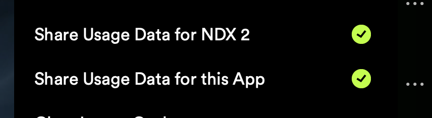

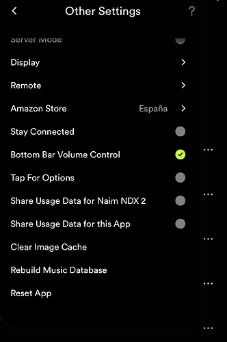

I tried unchecking the Share data settings which were previously set as shown below, but no effect of data amount.

You can find the relevant settings in the app under Other settings.

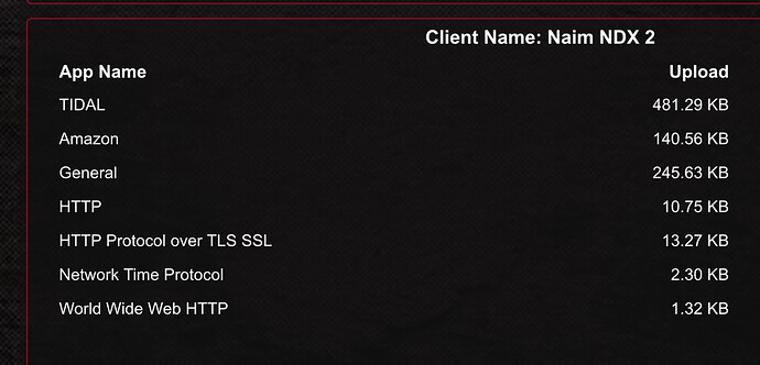

Interesting. Even seeing Tidal using 480K, that sounds like a lot, although it depends on if those stats are hourly or daily or weekly of course
