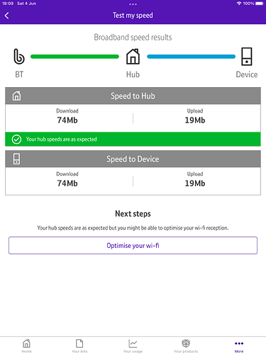

This is my wireless signal Mb in another room from the wireless hub.
Whatever, your 70mbs from that 66Mb - 73Mb BT package indicates a good strong connection.

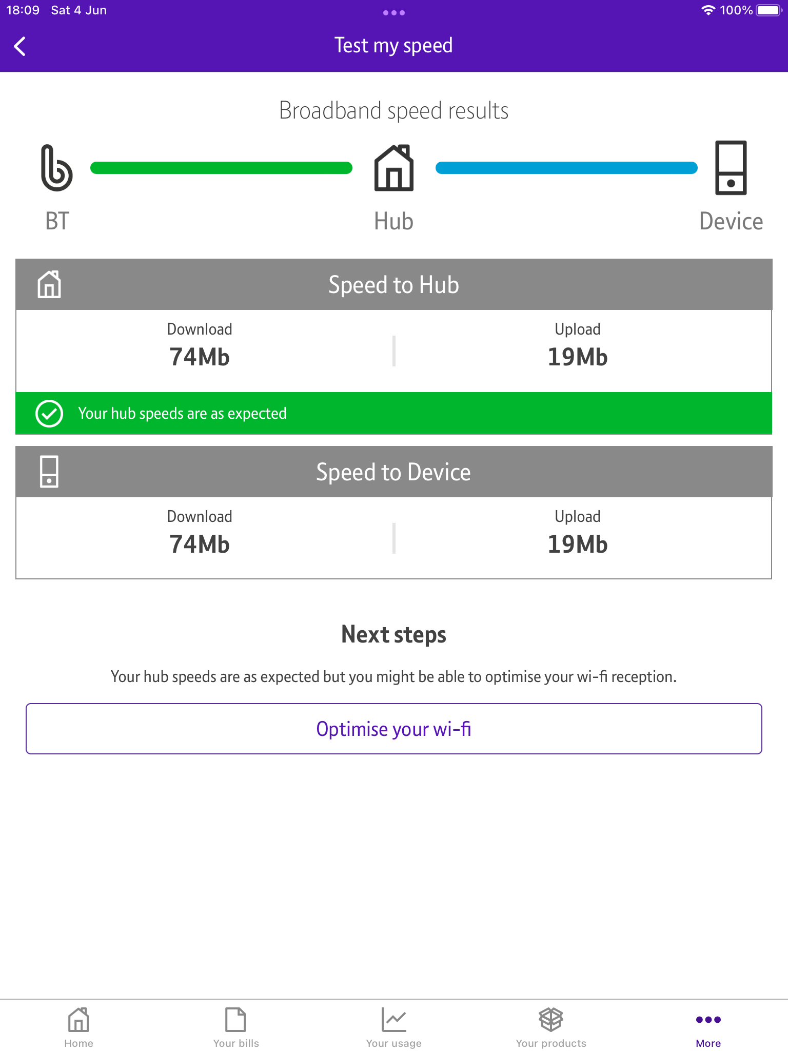

I get 74Mb from my 76Mb package
Yes but you can’t have speed higher than that coming into your house
What is that you are using to test it as it looks quite good?
Looks like the BT app but you have to be a BT customer I believe.
Its BT’s own test that you can find in the BT app
It shows both incoming to the Smart Hub-2 & also to the testing device, in my case an iPad fixed on the 5GHz wireless band
