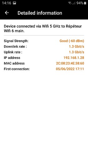

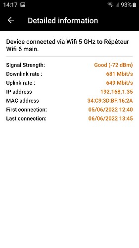

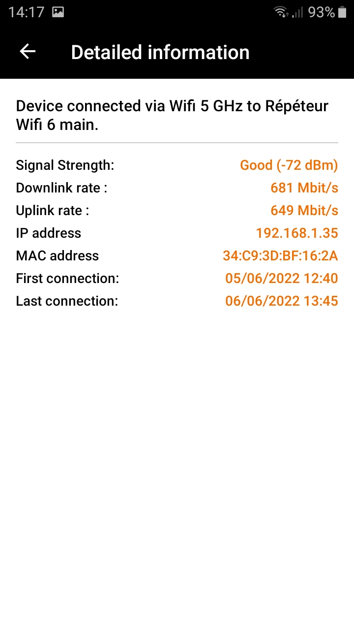

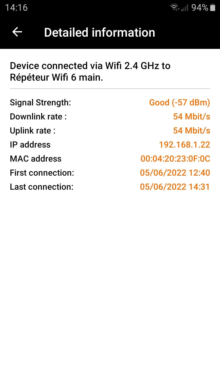

Wifi sweet spots are usually close to the Orange app I use here in France.
Don’t forget to run the app on the right device, mobile phones at 2.4 GHz will likely be limited to 70 ish Mbps speed, and will therefore only report that as the max speed. Same app running on an iPad at 5GHz will report up to 1Gbps.
The Orange app for France will collect speed data from the device itself and report that. eg. The phone app reports 70Mbps, but the same app reports its collected speed from my Chromecast as 585mbps.
Also a general point for anyone, most routers will now allow you to select more than one ssid, one for 5Ghz, one for 2.4 Ghz. If you run two network ssid and on your connected devices, select the matching network, you will likely find an improvement in network connections. eg. My Android phones and Sqbx’s run on ssid home24, everything else on ssid home5.
