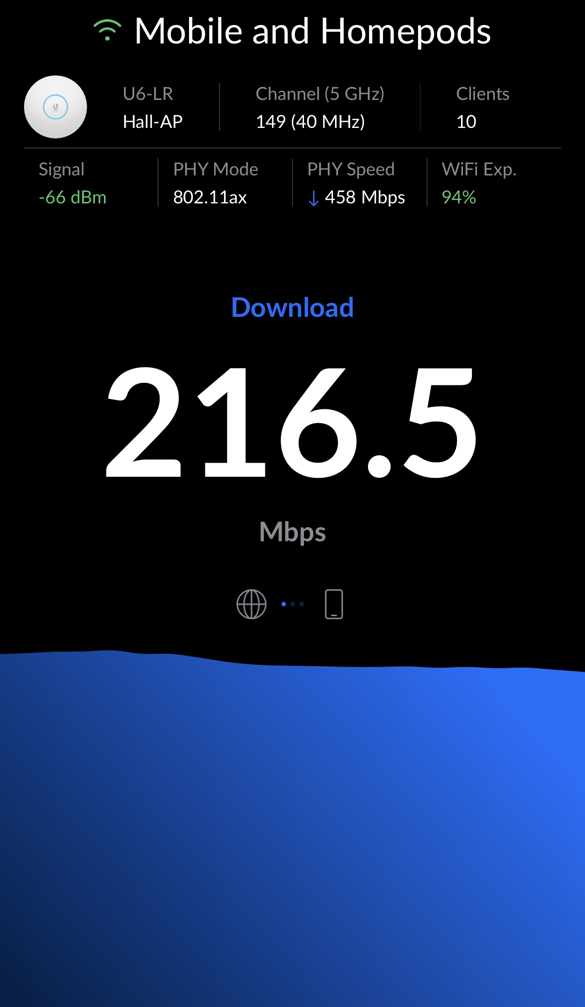

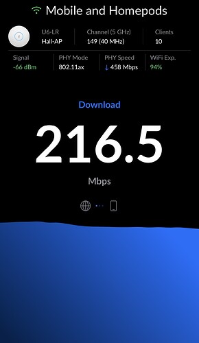

We went over to Giagclear, which is fibre to the house earlier this year and chose their 200 mbs service.
Our test results are very consistent with this and we get:
  • 230 to Ethernet
  • 200 to Wi-Fi

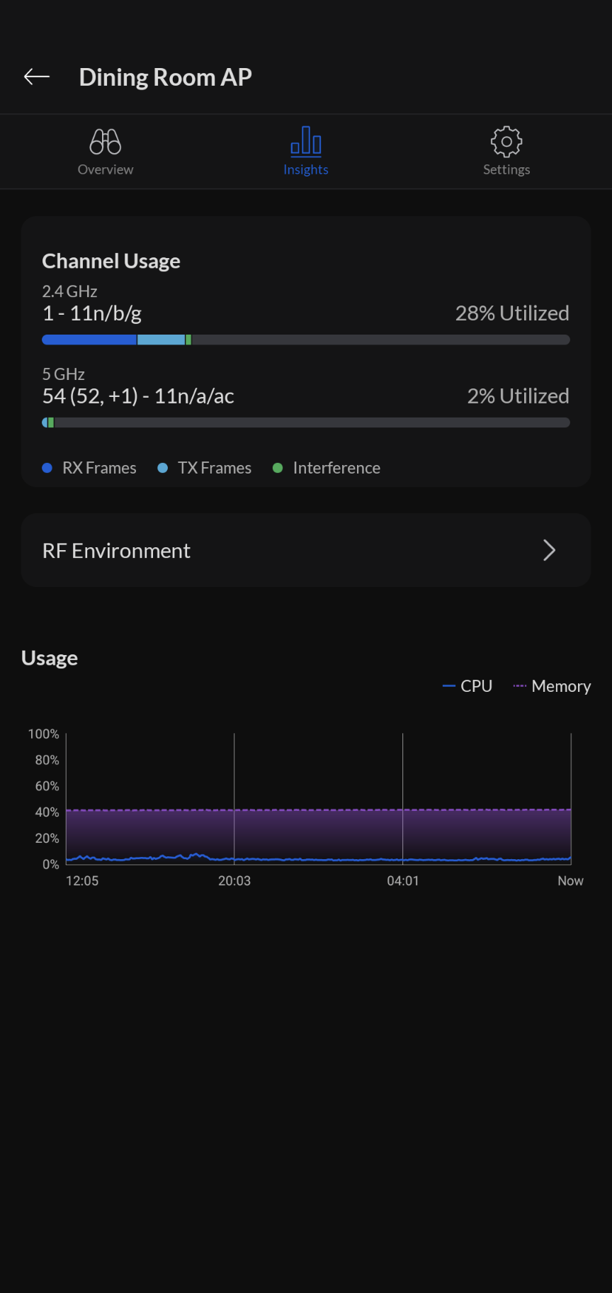

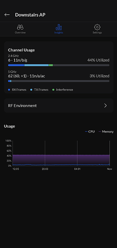

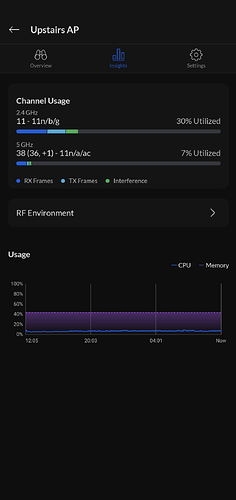

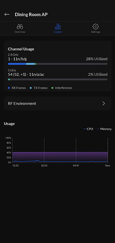

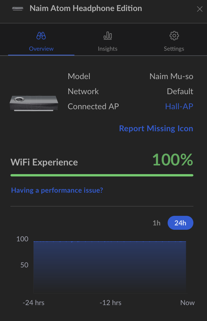

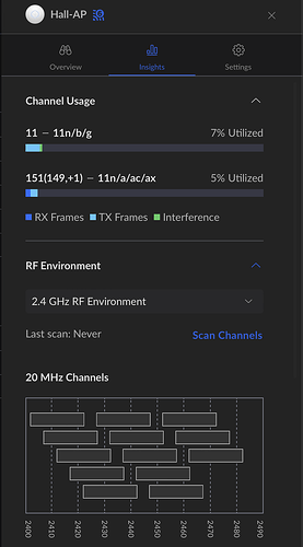

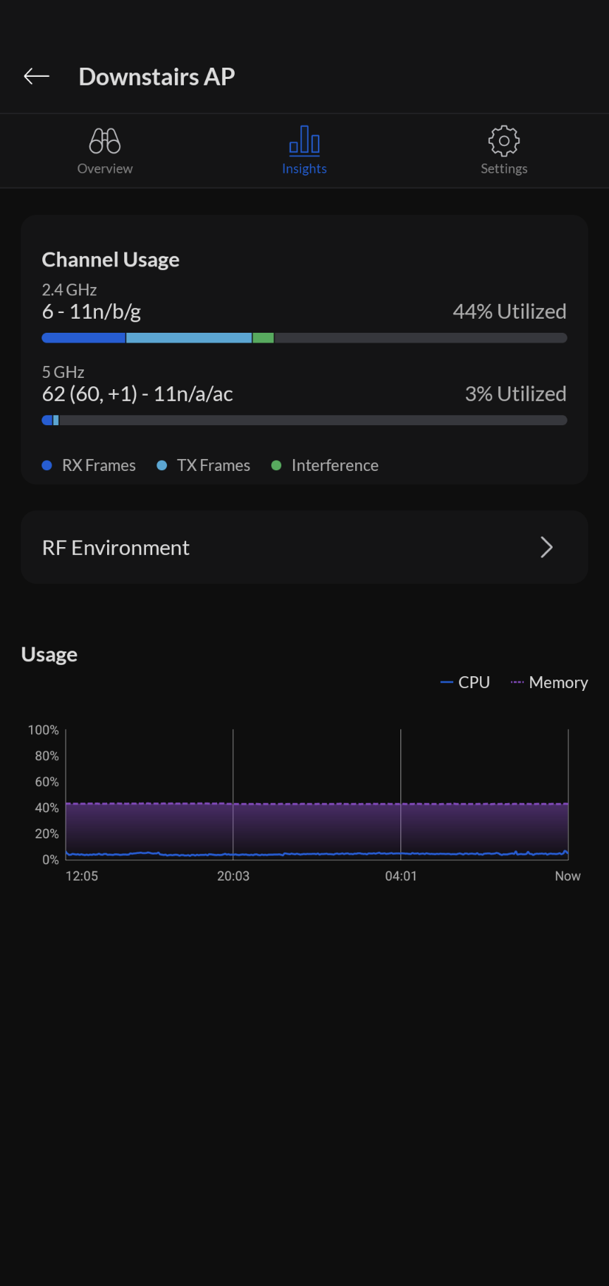

I tend to scan WiFi networks to see what the neighbours are using and from there, decide which 3 non overlapping channels I use, one for each access point. This helps keep interference down and WiFi speeds up. The AP below has 10 clients but the WiFi network tested only has 3 of them. It was setup for 5ghz only clients (Atom HE being one).
Which I could get less crowded on my 2.4ghz like yours, Rx frames are too high here and I only have about 4 X 2.4ghz devices across 3 aps. Some times of the day it’s as high as 70 -80% utilised. Price I pay for being in a built up suburb. No issues with 5ghz.
