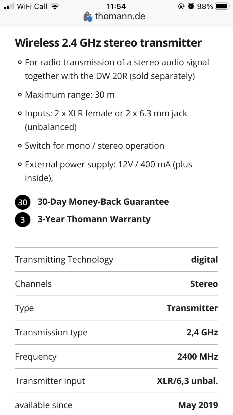

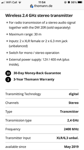

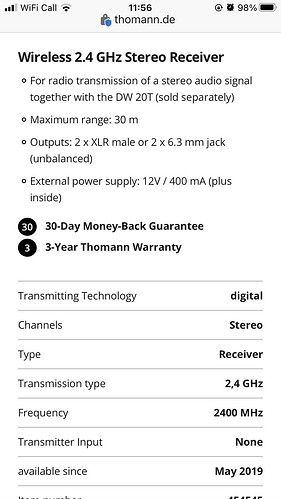

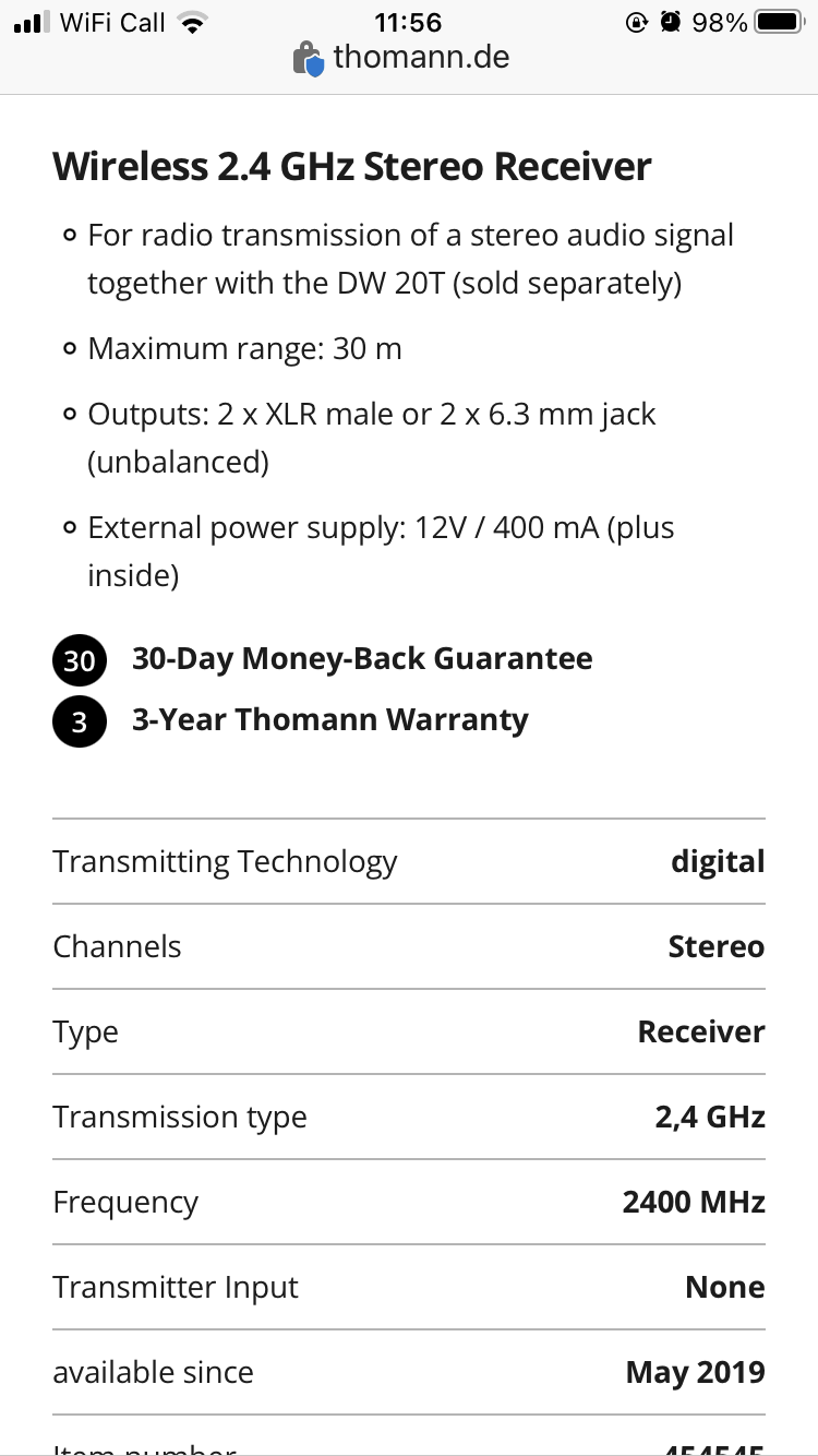

It appears you are looking for some kind of send/receive wireless system, where the speakers are in another room. You would have to attach the “sender” to the preamp output of the atom.
And then one of these on the other end, plus active speakers.
