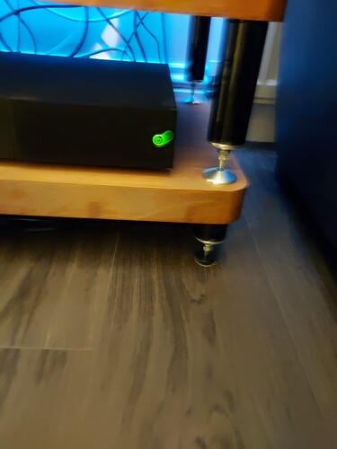

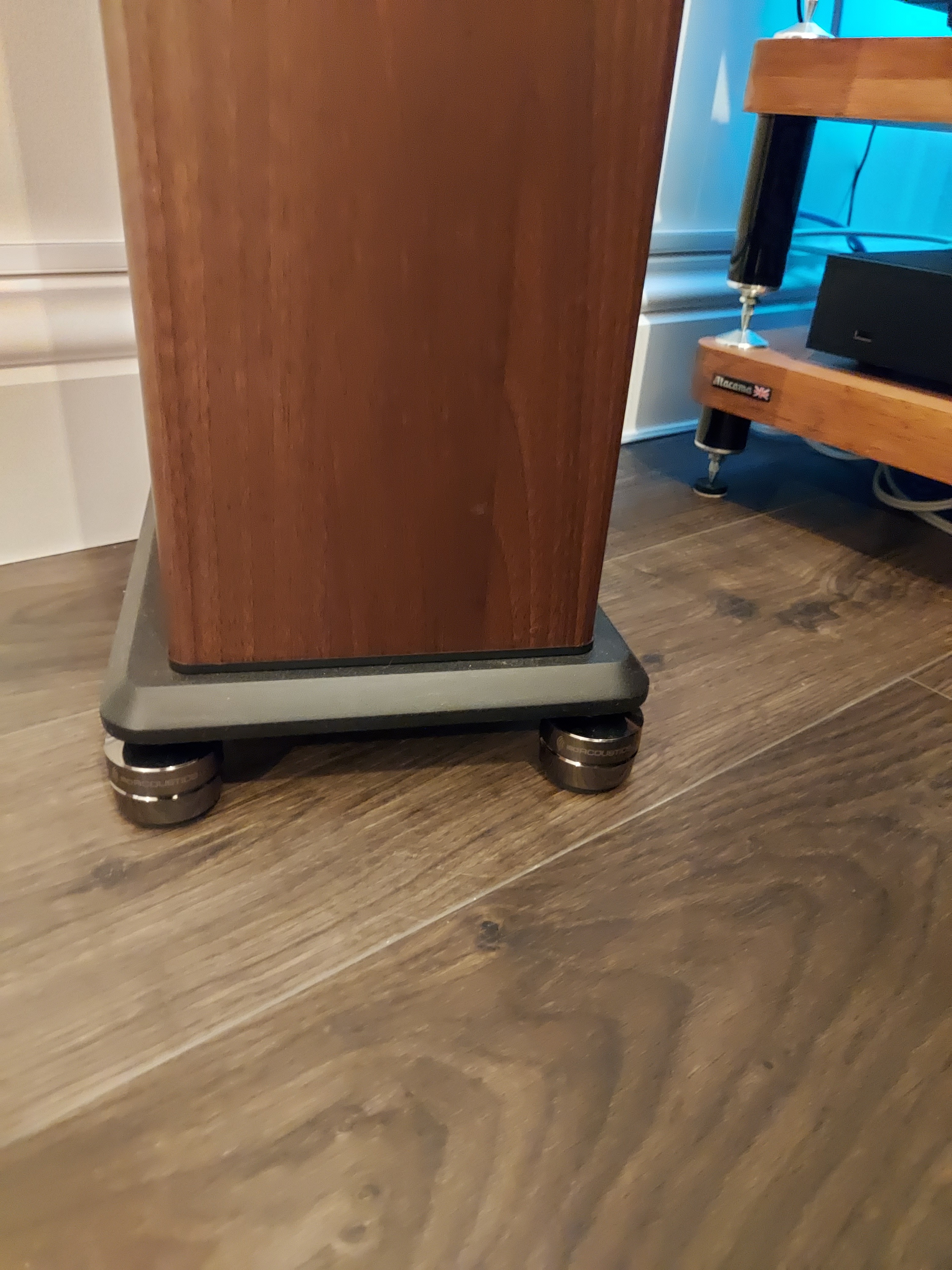

Thanks for the photographs. What are the supports shown in them?
hi Neil
Iso acoustic gaia for the speakers and atacama floor spike protectors on the rack.

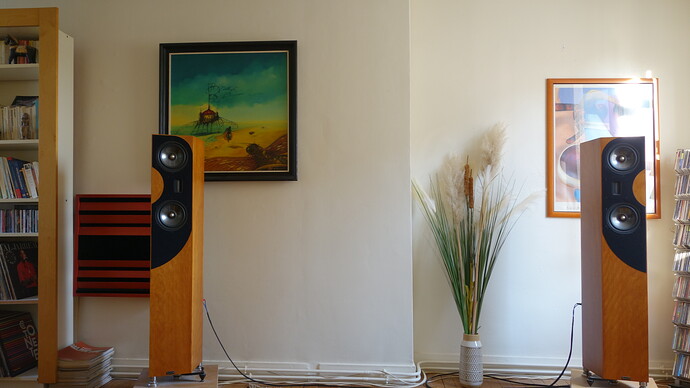

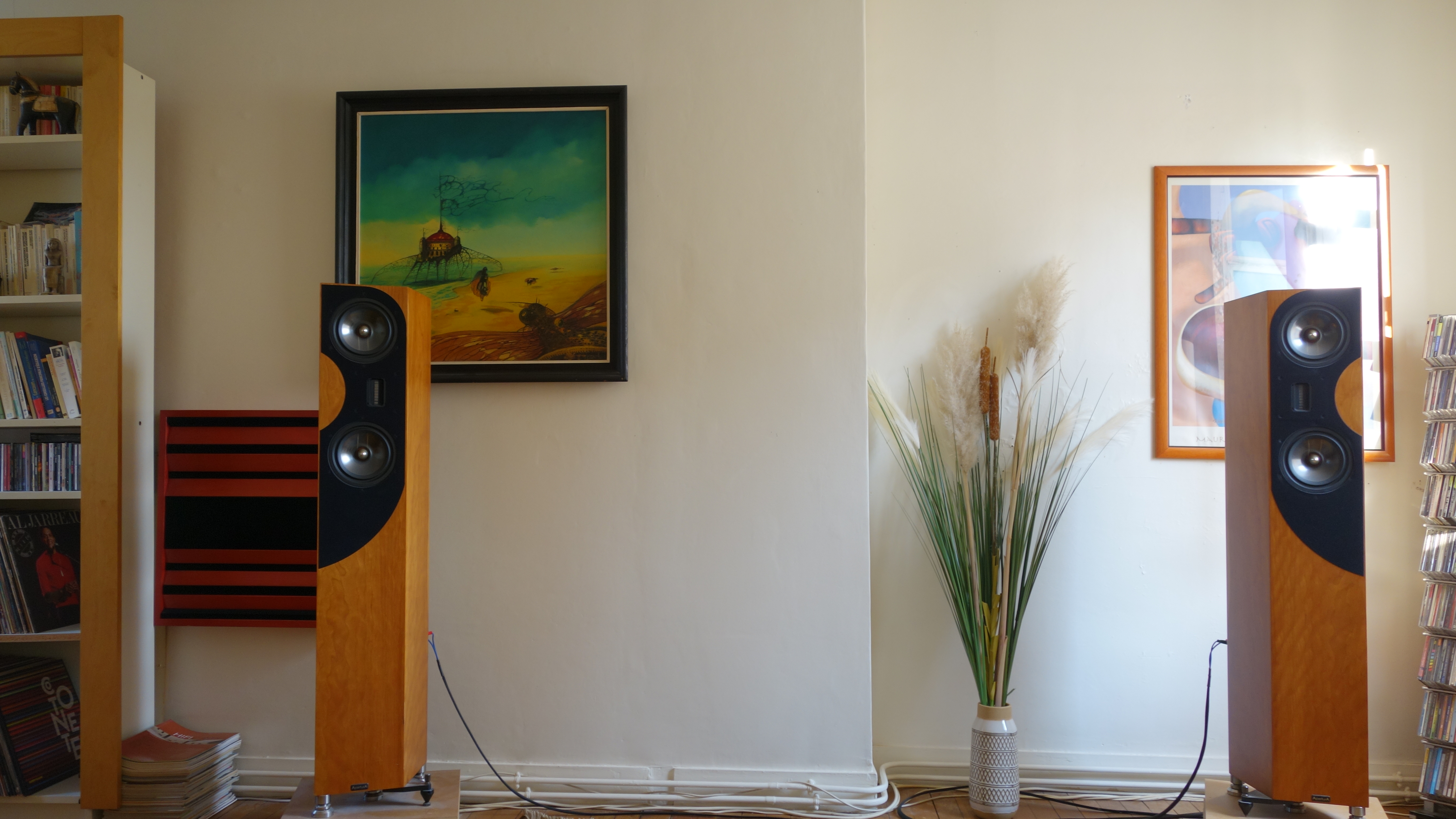

I also have wooden floor on concrete. Speakers are Monitor Audio Gold GX 200. They are nice but quite bass-happy, which was just right when I bought them for a smaller apartment. Since then I have moved, and it is now a large (45 qm) and high (3,3 m) room. I don’t think the floor is a problem, but room modes are obviously much lower, so bass is now a bit much.
At first I kept using the Audioplan AntiSpikes, which I had been a fan of and used for a long time in the old apartment. (Edit: Nobody’s heard of them on the board I guess, but they are cheap to try from a well known auction site. Easy to handle (check the manual, it must be followed for them to work) and level, a good level of friction on wood floors, and can work very well in the right setting IMHO). The first attempt at improvement was to go back to the original plinths and spikes that came with the speakers, and put them on blocks of slate. Which helped, but the wooden floor is not very even (although new), so it was difficult to keep the slate blocks from wobbling.
Recently I tried IsoAcoustics Gaia III (got a good used set at a good price) and am keeping them for now. They helped somewhat with the bass, but not that much as the problem is most likely room modes & speakers. The sound in the bass is very good actually, just still too much. Mids and treble were more improved, with more precise sound stage and 3D. I also like them from a practical point of view: Easy to level, and the suction cups on the underside stick to the floor and keep the speakers from being moved by the Roomba, or even toppling them with a stupid movement (they are quite narrow without the plinths).

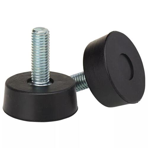

I have Engineered wood floors and to avoid damage swapped out the mental M8 spikes on my equipment rack and speaker stands for some nifty (and cheap) rubber feet from here…
This bunch do all sorts of handy rubber components that lateral thinking audio-nuts can find uses for :+1:

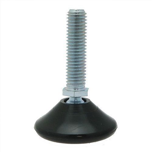

Or… Adjustable Feet For Machinery & Furniture, Table Feet - Vital Parts
These are £1.50 each, M8 studding, 30kgs load rating (each). Might put stillpoints out of business??
I think I paid about £12 for eight threaded Rubber feet. They come in various load ratings and thread sizes and offer a degree of isolation from vibration for peanuts. So before splashing ££££hundreds on snake-oil products try these. If not satisfied then you haven’t wasted a tonne of cash.
