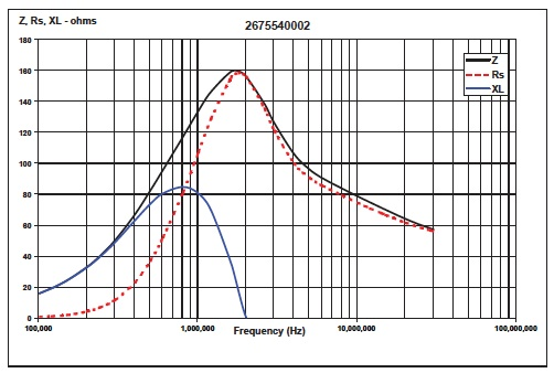

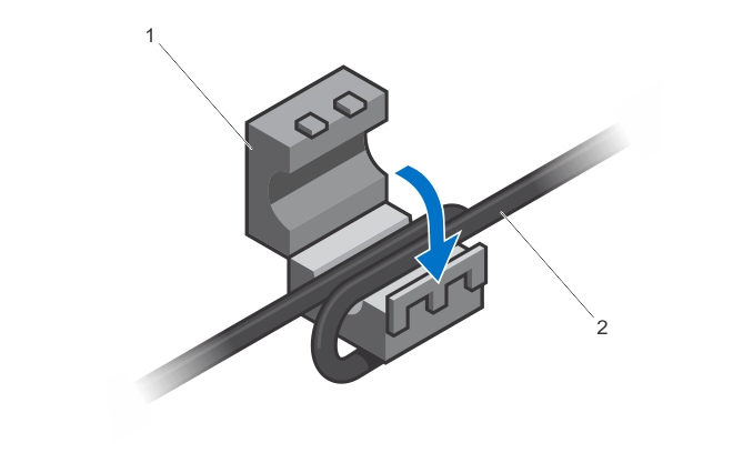

Just adding “some” ferrite is not that effective.
SMPS’s operate in the 25kHz to 3MHz range, some are narrower maybe 50kHz to 1MHz and this is at the very bottom of any ferrite mix (alloy formula) effective operating range.
The problem is most of the ferrite clamps you get from the www.stores use a general purpose ferrite mix & are only effective at much higher frequencies, typically 10MHz to 500MHz
I have a number of LF ferrite clamps on my SMPS, I have them on both the DC side & the 230v AC side. For this application I use a Fair-Rite “75” mix, this is effective between 100kHz & 20MHz & peaking at 1.8MHz.
I also warp the DC leads around the ferrite as many times as possible, each turn multiplies up the effective impedance & also lowers the peak fs somewhat.
Mike B I can’t find the ones that are effective between 100Khz & 20Mhz. Can you tell me where to buy these please? - Most seem to be effective between 200Khz & 30Mhz
Hi Chris, I bought mine in USA while I was travelling there.
I see UK vendors Mouser, Dig-Key, Farnell & numbers of others have mix 75.
I haven’t compared how each report the effective range, & it these can be reported different ways, but Fair-Rite are the people that make & licence the material & this is what they show.
Thanks Mike really great information. Looked on the Mouser website and found the Fair-rite 75 mix clamp and was wondering what internal measurment would be ok to wrap the average SMPS cable in 5, 6, 9 or 10, 13 or 18mm?
… errrr what diameter is the cable ??
Most SMPS cables are not so big, I have 4 or 5 turns around a 8mm core but with other cables its just 2 turns. Its up to you, 1 turn is double over 1 pass.
It’s just a bog standard SMPS Mike so no more than 5mm so perhaps I’ll go for the 8 or 9mm. Thanks again.
Just checked what I have & have 9mm with both the 75 & the other H30 mix I use.
