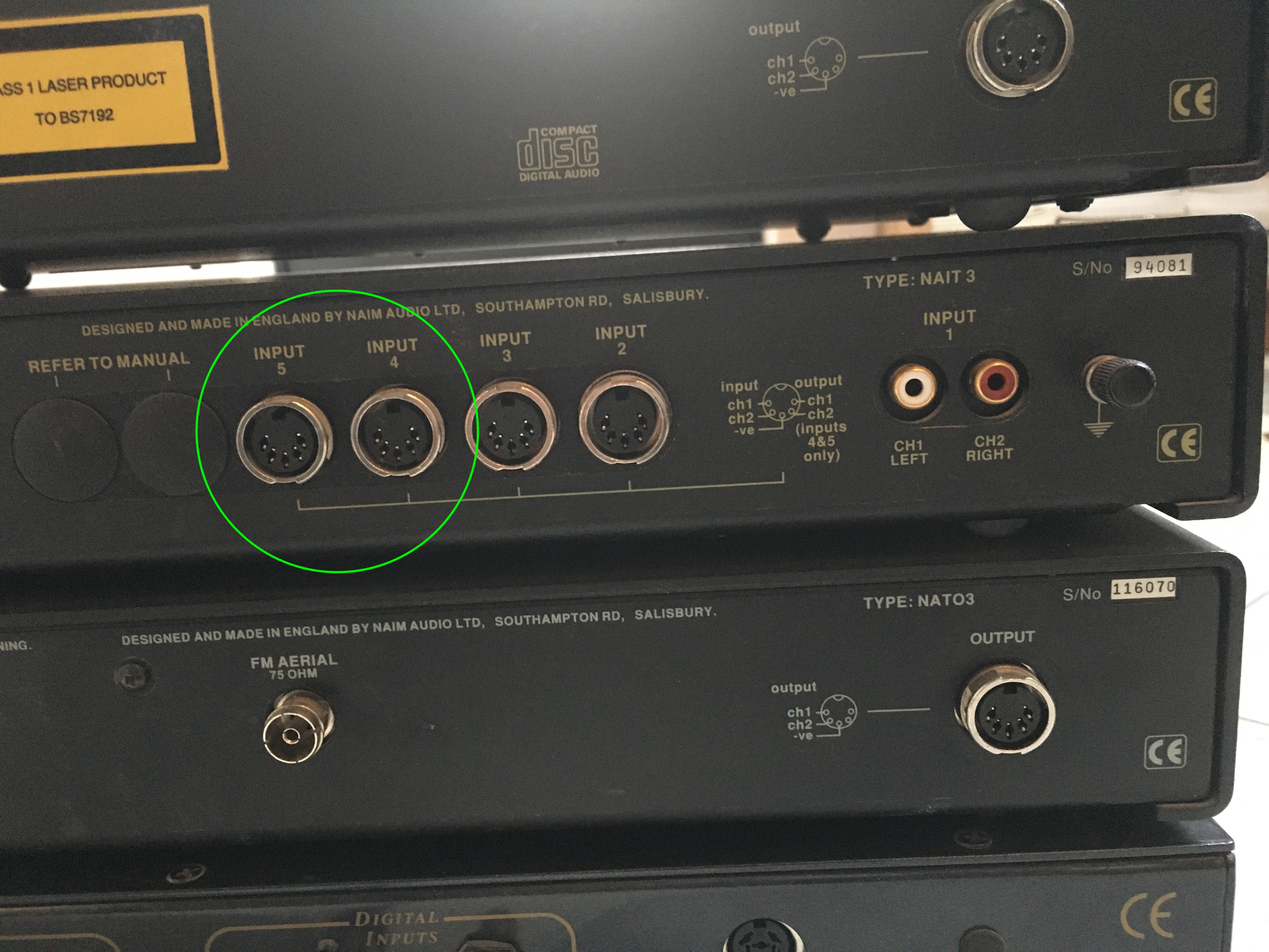

I am hoping one of these will work with a custom RCA to 5-PIN DIN cable as you recommend - the back panel of the amp does not specify balanced or unbalanced. Would you (or another reader) perhaps be able to tell from attached photo if this will work ok ?
Thanks for the great idea & hope this works - it will sure save a lot of re-rigging hassle if it does.
I will comb through the Naim forum for RCA >>> DIN cable recommendations - any particular one that jumps to mind for this particular pairing ? Sky is definitely not the limit cost-wise :slight_smile:
DIns 4 and 5 also allow for output e.g. for tape recorders. Just dont connect those pins or use a DIN → 4 x RCA interconnect. Doesnt matter if you do, you’ll just have 2 extra RCA’s with nowhere to go.
Look for a standard Naim interconnect aka “lavender” (a reference to the slight purpleish hue of the grey cable) 2 x RCA → 5 pin DIN, or a Chord one.
This is the Naim “lavender” (this one has a 4 pin din but otherwise the 5 pin din version is identical).
To the right of the inputs, the wiring pin diagram is what you need. It is definitely not balanced, and there is a shared negative pin for the inputs. This will definitely work fine.
I see Robert has supplied the Naim cable info for you… but if you are a little bit handy (or anyone you know is) then you can easily make such a cable yourself with decent four-lead wire (Mogami is a popular brand) and the appropriate 5-pin DIN connector at one end (make a note of which colour you solder to which pin, and solder two wires to the pin marked -ve), then use two RCA connectors at the other end (the centre pin is +ve, the outer ring is -ve).
Be careful to note the wiring diagram doesn’t specify PIN numbers, but the convention (ie usually but not certainly) is to illustrate what you see - in this case the socket, and thus the same orientation as the “inside” of the male connector that you will be soldering to.
It’s not expensive to get good quality wire and connectors, so if cost is at all an issue, or if you just want to verify that it works as you hope, then you could be very pleased with the result of a home-made cable. I understand that there are quite a few custom companies (possibly including Witch Hat) that will make up these types of things as special order (make sure you give them that photo!) but I have no idea of price.
