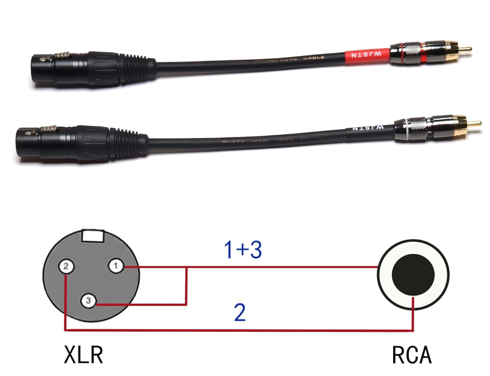

I decided to get a set of Siltech balanced cables, and use pigtail adapters (female XLR - male RCA) into the RCA AUX2 input on the 252. That works great and has future-proofed me on an expensive cable whenever I change to a balanced preamp.
Boulder is making me a set of nice adapters, but in the meantime I got a cheap set from Amazon.
As a warning all the adapters out there short Pin 3 to Pin 1. That’s more for pro equipment that need to unbalance connections but for hifi gear you almost always want Pin 3 open. It’s not a big deal to open the XLR connectors and snip the short to open it.
These are about 6” long, and solve the problem for XLR barrel adapters that the 282/252 RCA inputs are too close together.
