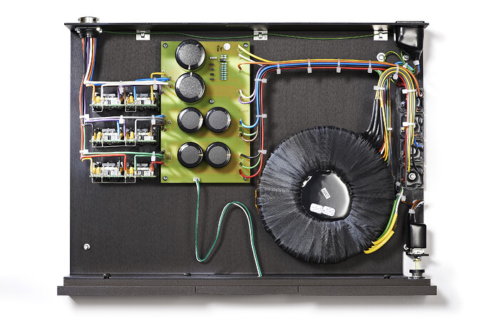

Are the big caps replaced when doing DR too on XPS? I have bought a 2010 XPS2 which was DR in 2015 so I was planning for a recap but on the reply you added it seems like it’s not needed?
I’ve looked at some pictures of the inside of XPS and it seems like it had one big PCB with the bigger caps on it where XPSDR has a smaller board for the caps and the DR parts added next to it. This I would assume means XPS being DR has new caps in it so time till service would be from DR is made.
XPS

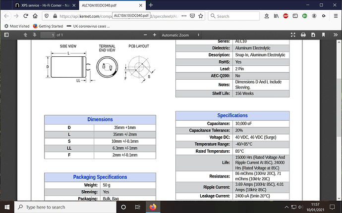

Class A advised 14 years life for the electrolytics in the XPS.
Naim use long life caps in the XPS. 15000 to 24000 hrs at 85C
Cost £5.25 each for a box of 100
That is quite a time extension to 24,000 hours. Clearly they should not find the self’s exposed to 85 degrees in many Naim power supply applications.

Yes today it does but that was introduced not long ago I think? So a DR made in 2015 can be without recap I think. But for XPS to XPSDR they change the PCB that contains the big caps and I find it hard to believe they remove the old caps to resolder on the new PCB given the cost in time vs cost for the parts. So most likely DR for XPS atleast include recapping due to swapping out the full PCB board.
For those wondering about the need of service on an XPS updated to XPSDR Naim has confirmed they swap out all internals except the transformer meaning a service intervall starts for the day DR is made on this box.
“during the update process, we pretty much replace the entire inside of the unit (save the toroidal transformer) so effectively - there is nothing left to service.”
