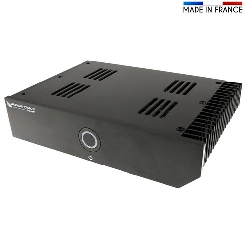

Audiophonics. 12v / 5a
Caractéristiques :
- Boîtier : 100% Aluminium brossé et sablé
- Anodisé noir
- Tension d’entrée: AC 220V
- Tension / courant de sortie: 12V 5A DC (7,5A en crête)
- 1 sortie Jack DC 5.5 / 2.1mm
- 1 sortie jack DC 5.5 / 2.5mm
- Embase IEC avec porte fusible
- Transformateur 100VA
- Régulateur de tension LT1083
Should it power correctly 12v / 2a?

As 5A is higher than 2A, yes, although I’m not sure why they also quote a 7.5A max.
Yes. The voltage must be matched, so 12V and 12V. The current required by your device, 3A must be available from the power supply, so a minimum of 3A. 5A gives you some headroom. So basically the V ratings must be equal and the A rating of the power supply needs to be at least equal to and ideally a bit higher than the A requirement of the device. (Don’t get carried away and have a 100A power supply on a 1A device.)

I think that means a peak power, so 5A constant and OK if it goes to 7.5A briefly sometimes, although I don’t understand en créte in that context.

Crête is Pic current. Just the translation, not the understanding.
It says the voltage regulators are designed to deliver 5 A at 12V but with the given transformer (100VA = 100 watts) the output current requested over a very short period (in order to manage peaks in consumption) can be higher (up to 7,5A).
