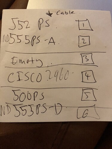

I did this when I got my 2nd PS - this was the scribble I made…

have you tried it with the Cisco off the block? That was better in my system
Strange to me…is this order is so important?
I tried and found it better on the block. Only me of course.

Using the above diagram approach I use:
House Mains:
All my Cisco stuff
HiFi Mains:
Bank of Wall sockets:
All the Power Amps and Melco
‘Middle’ wall socket pair:
Snaxo SC supply
Dis-board:
Empty
Empty
S1 Pre
555PS - A
Empty
555PS - D
I arrange the sequence so that everything is daisy-chained and the ‘return-path’ loops between the boxes via their supplies do not form a mesh but rather a series of loops one to the other. The HF current equations are less complex and it to be sounds cleanest and most dynamic.
The loop is made by any electrical contact: so mains and signal will be part of a potential loop through the HiFi and its supply. There are no perfect insulators - always a path especially at HF - the HiFi is most wide-open at certain HF frequencies and will contain components that will both turn circulating currents into voltages inside the box but also provide a non-linearity to allow inter-modulation between close frequencies down into audio-band - and you will hear it as various kinds of noise.
HiFi tries to design it away - but nothing can be perfect as we have to work with boxes with seams and components with inductance.
The reason I put my Power Amps onto the wall sockets direct is that they are noisiest as they are the only non class A supplies. They draw high music-dependent dynamic currents that will create IR drop voltages invoked into the other boxes it they have to be pulled through the block - so the block ‘floats’ or ‘rides’ as a kind of raft seeing the same voltage (the voltage noise on the mains supply created by the Power Amp class AB supplies) and null-referencing it out as it will be the same for all items plugged into the block - they are all class A.
Digital supplies create their own issues but have far lower currents so you can find a place for them with some care.
Try experimenting and see.
I devised my approach based on work I’d done with instrumentation amplifiers where injected noise reduction is critical - it was a place to begin testing, but any other approach that sounds better is by that deduction ‘better’.
DB
