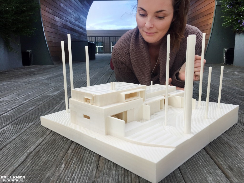

This is the kind of result I would be looking at. An architectural model with some landscape/terrain shown, scales generally 1:500, 1:200, 1:100 and 1:50 if possible.
The other advantage is I could print sections through buildings if the building was sufficiently interesting or complex.
This image is plucked from the website simplify 3D and is used for advertising 3D architectural prints, so I dont think it has copyright issues for an architectural firm.
The other considerations for me, would be to make the model as clean and precise as possible. I am not too keen on this off-white colour, pure white would be better. Then, sometimes I would be interested in showing a particular texture if it was important for the architectural design. That would need to be clear at the right scale. I guess thats a slicing/file issue that would need to be investigated.

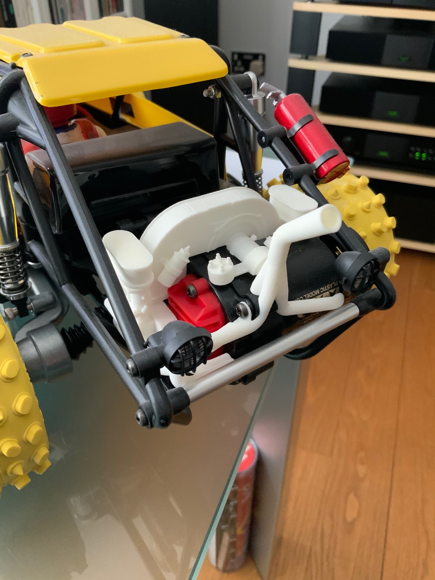

What kind of components do you get printed? Any chance of showing an example and what is the material? I assume the component would need to be quite robust for RC car racing?

@JOF here is a buggy I am building at mo. It is based on a VW sandrail and all the white parts are a fake engine just for looks. They will be painted but I am still building it at moment. Objects can be printed in various materials (as I am sure you know) and things like suspension arms are much stronger.
Cool stuff biddler.
But then I guess the ‘working’ componants will be made from a different material and/or where required the component will have a thicker layer of plastic for strength.
Then just to recap - those white components are designed by you in a proprietary software you have on your computer at home, then you send the file to a web site who then print the component(s) for you. Then the components are delivered to you via the post. And you pay them a small amount for the materials and time.
Is that correct biddler?
I think that if you want very clean and accurate prints (no layer lines) then you would either need to use resin printing (but they tend to be more limited in size) or spend some time after printing with files, sandpaper, filler etc.
