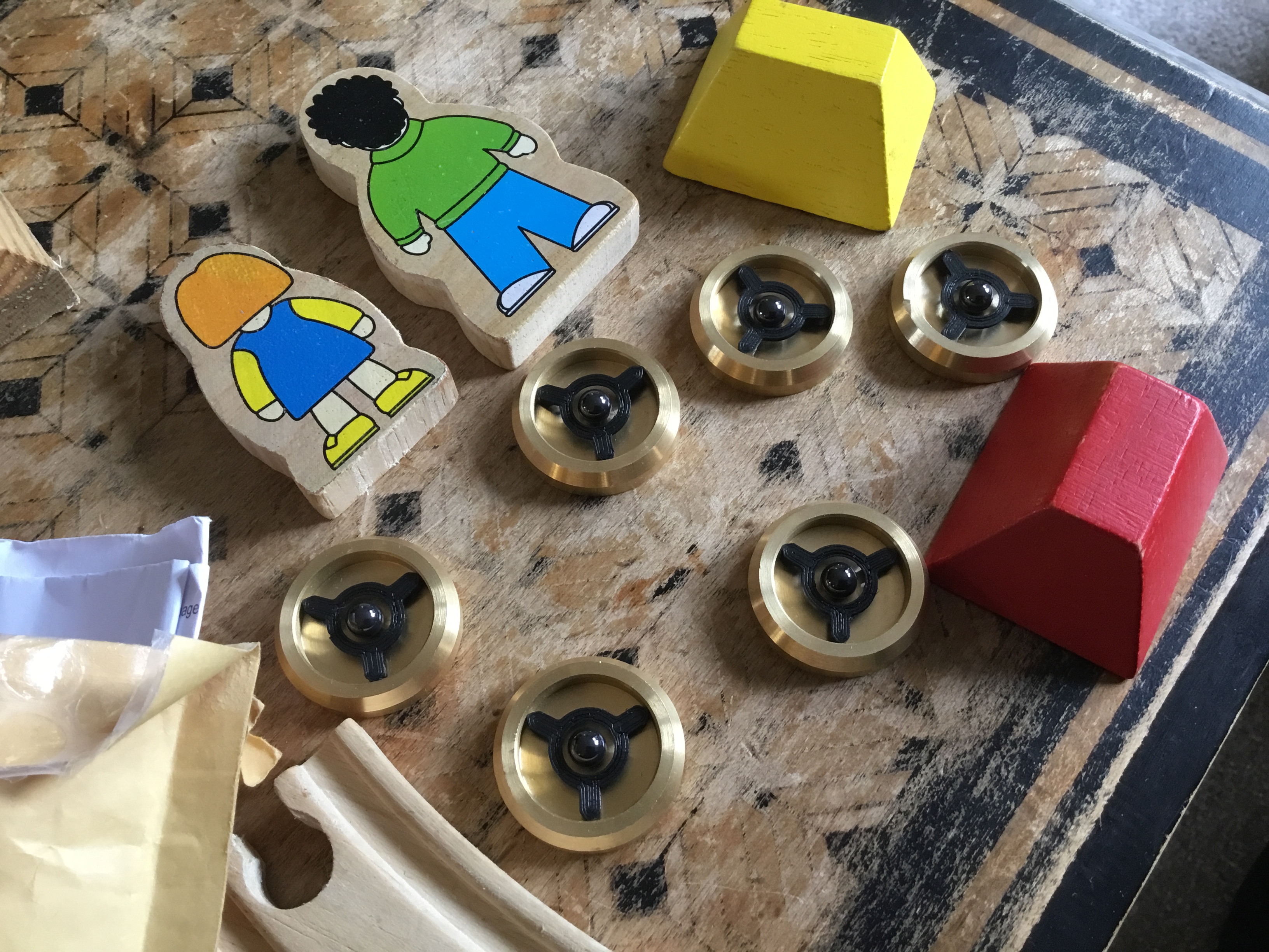

Parts for the brass cup & nitride ball vibration isolators.

Could someone post an example of what they are producing on these home machines? I am just curious
Bruce
The black bits.
