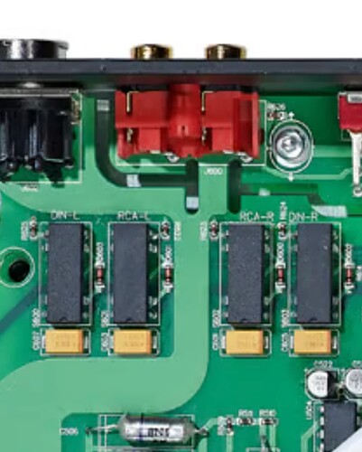

Not sure if you mean the ND5 XS2, if so, maybe this helps!?
You can just make out the labelling, 4 relays, 2 each DIN and RCA, one per channel. As you might think actually :slight_smile:
that is helpful.
Will need to check with Focal-Naim NA whether they just replace one or both of the relays.
Would assume only one is broken (the right) since only right channel is missing.
David
Almost certainly just the one….they are more likely to fail when new🤞🏽
