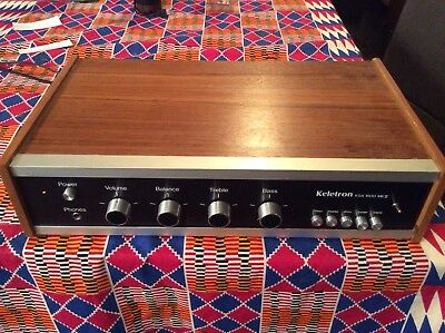

My first amp a Keletron KSA, a full 7W per ch!!
Vintage-Keletron-KSA-1500-MKII-INTEGRATED-AMPLIFIER|400x299

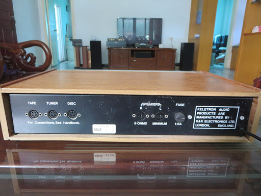

Note: actual wood veneer sleeve on a ÂŁ15 (new) amp, 2 pin din sockets for speaker connections and reference to handbook on how the pins are wired. :0)
