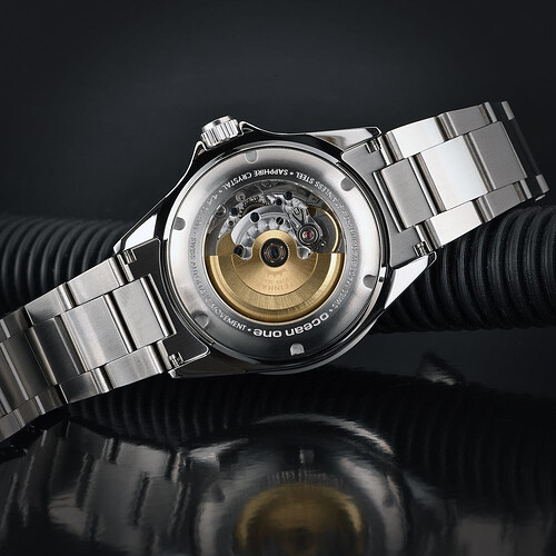

A couple of weeks ago I bought a mechanical watch, something I thought I would not do. I did a fair bit of reading before I bought it and have done a lot of reading in the two weeks since. My watch has the premium version of the Selitta SW200 movement, which is a volume produced movement but appears in watches far more expensive than mine.

New watches door may slow down a bit in the first few weeks as they settle down and may benefit from an adjustment a couple of months in. Mine was within 2 seconds per day in the first week. After I reset the time it dropped to about minus 4 seconds per day. After the 3rd reset it about minus 6 second. Not sure what is going on here.

You appear to have the ā€˜Top’ movement. Adjusted in five positions; accuracy of +/-4 sec/day up to +/- 15 sec/day
Credit: Caliber Corner Ā© 2022, All Rights Reserved. Source: Sellita Caliber SW200 Watch Movement
So -6 sec/day is well within this range. (Personally, I’d be happy with this and if I wanted a more accurate mechanical watch I’d look at a COSC chronometer this should run -4 to +6 sec/day.). People who want better than this should buy quartz.
