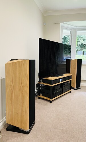

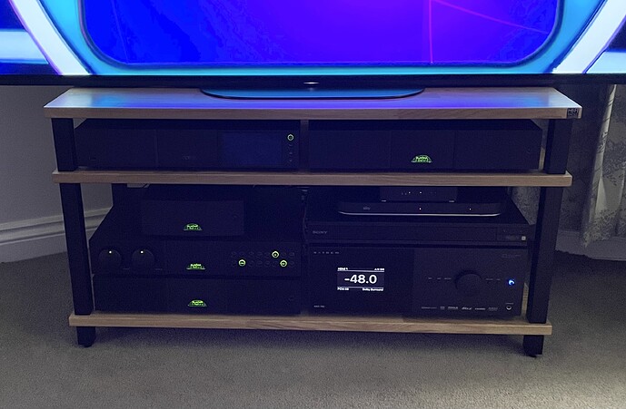

Yes, it is all sites together, like this.
Nice! Are these the 606s? I have those too! I guess the 282/250 has enough power to nicely run the 606s in your opinion?
And hide the pics away - the naim audio stacking police will be around soon! :slight_smile:
Yes, Titan 606’s. They look and sound fantastic. The NAP250 drives them comfortably - lots of volume with the dial only a quarter of the way round at 9 o’clock. As for the ‘cable and stacking police’ on this forum, I tend to ignore them - it’s generally a load of nonsense in terms of gaining any tangible audible differences. Enjoy the music!
