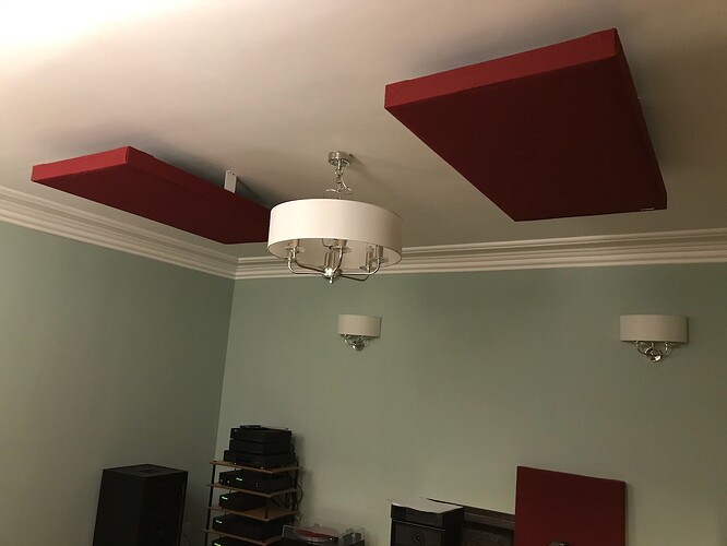

I have two GIK242’s on my ceiling.

Hi what do you think sound wise and I would prefare to hang flush to ceiling if possible. But looking at yours they seem OK on the gik bracket.
I have detailed my experience with GIK acoustic panels elsewhere. I contacted GIK and just took their advice at face value i.e. installed the panels as prescribed and haven’t experimented as some on here clearly have.
They advised getting their Room Kit #3 + an extra 242. I fitted the two roof panels equidistantly i.e. the room is 4.7mtrs long so they were fitted on 1.567mtr centres which neatly fitted in around the centre light fitting. I’m assuming there is a good reason for the roof panels being distanced slightly from the ceiling using the GIK supplied brackets?
The centre point of other two 242’s are fitted at the first reflection point along the side walls i.e. 1.79mtrs.
The bass trap is, currently, just stood against the rear wall waiting on the new curtains being hung.
The other piece of advice I took was to move my listening location to 38% of the room length from the front wall i.e. a near field position as this is the best ‘null’ point. Yes it seems odd at first but it is a dedicated listening room and the chair is the only piece of furniture in there.
I also have to add that I already had Linn’s Sound Optimisation (V2) in operation when these panels were fitted.
The impact of the panels collectively was transformational especially in respect to the bass. The implementation of SO had already made some inroads in to eliminating the peak at 36.6Hz but the panels suppressed this still further allowing what was previously being masked/ suppressed to appear.
The lower bass region became much clearer and the whole sound stage much more detailed and ‘open’. I hadn’t realised how much the room was impacting on what I was trying to listen to.
