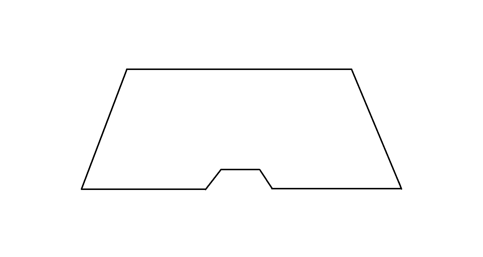

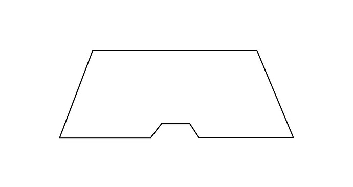

Ok, here is the rough shape of it:
The material thickness is 12.7mm
The bottom horizontal width is 380mm
The top horizontal width is 280mm
The vertical is 190mm
Distance from bottom corners to notch is 130mm
Top of notch is 60mm
Depth of notch is 30mm
Notch angles are 45 degrees
Regards
Neil.
