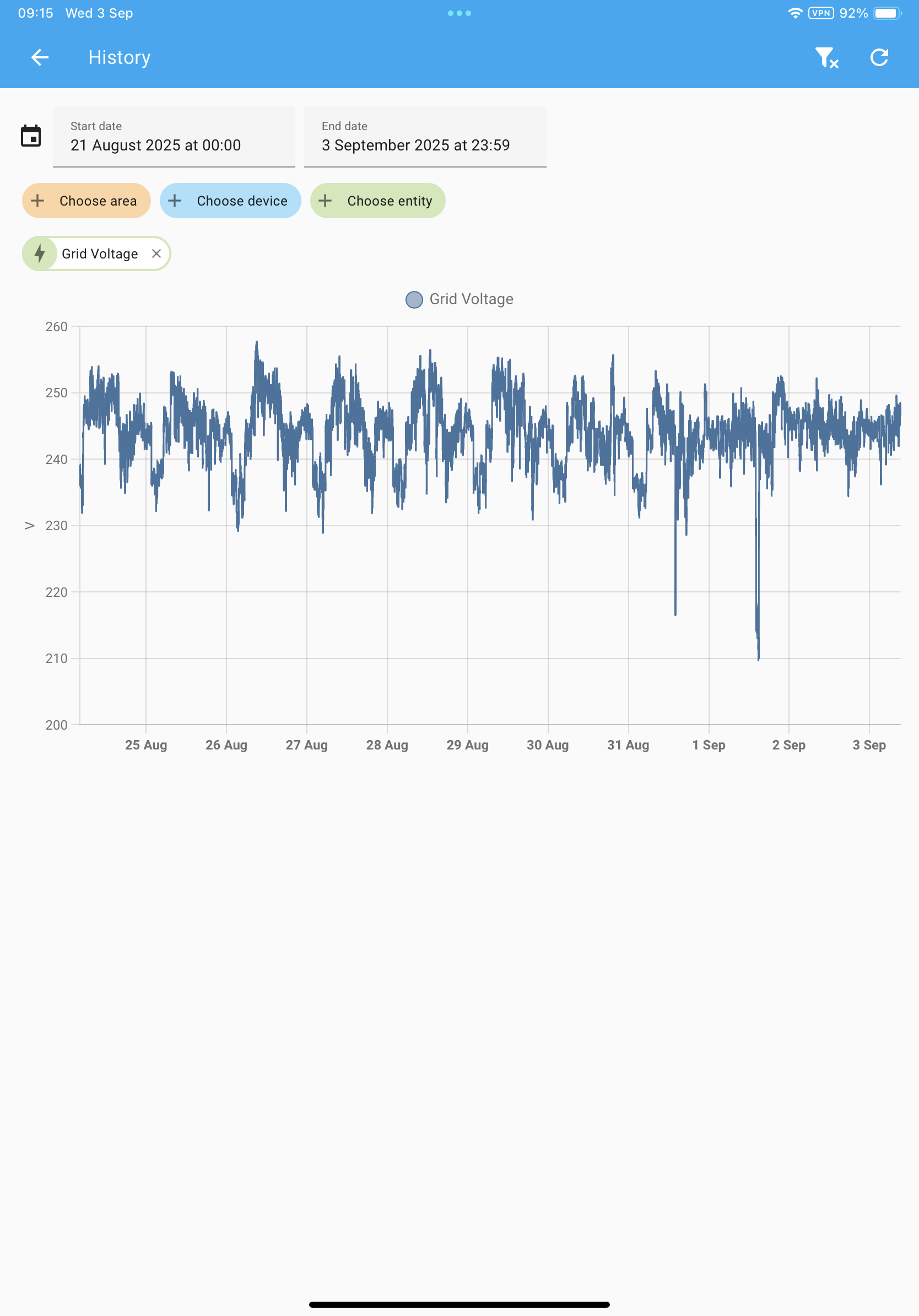

The SolarEdge problem meant the battery didn’t charge last night. So I turned the Inverter off following the procedure and back on again. After 5-10 minutes it was all working again and a test charge worked as did the 1 hour of free electricity. We were running at 15kW and the grid dropped to 221V. I guess lots of people were helping the grid deal with too much wind and solar. I will export after 7pm.

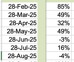

Going back 3 years of data, this year has now surpassed the other two by >10%
I had one day recently when the grid voltage exceeded the U.K. upper limit. Then on Monday during the free electricity hour it dropped below the minimum.
Phil
I had 25 years of over-the-upper limit voltage to my house before I got SPEnergy to change the tappings on the nearby substation transformer. I did get to see it when they did it, and it wasn’t toroidal or made by Naim
