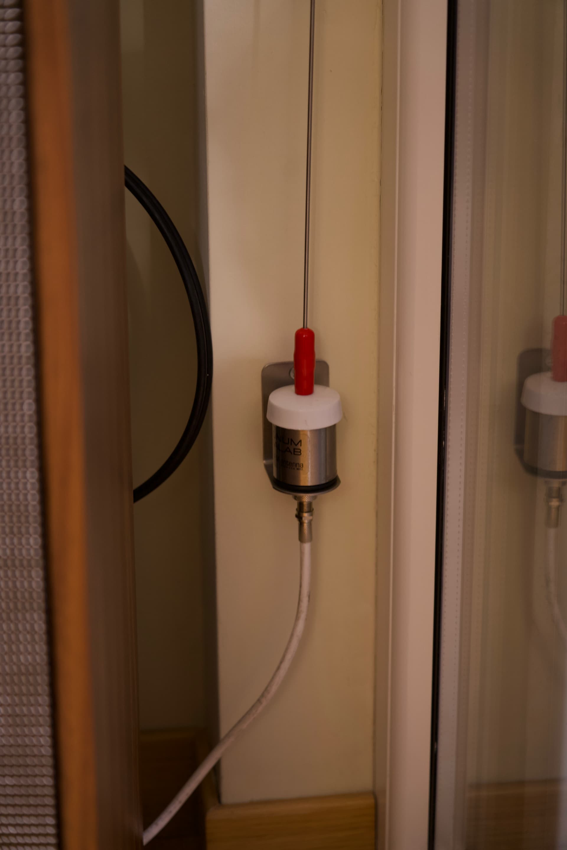

Hi Toscana,
Magnum Dynalab for me too.Great antenna.While waiting to mount it on my roof in some way I’m having it fixed to the the wall under a curtain inside my listening room and close to a large window.
Will show you a pic of it as soon as possible.

I tried both. Outside is better. We cannot put it on the roof unfortunately, which would be the best, although this would result in a long cable. HR2 sounded pretty good even with the antenna inside but better attached outside on the balcony.
