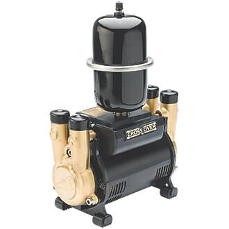

Since re-fitting carried out by a bathroom installer, we now have a single shower pump, a Salamander CT30 situated by the hot water tank, feeding the two showers.
The first when fitted was much noisier than we expected but worked OK. However it got noisier and noisier and was starting to sound like a bag of spanners before it failed 4 months in, it just stopped working/seized and was scorching to the touch, so assumed it was a wrong-un from the start and eventually lunched itself somehow.
Replacement obtained, fitted by installer and was fine, much quieter from the off and sounded like our old Aqualiser pumps, which made me wonder why our installer didn’t figure the first one was duff from the outset…However within a couple of weeks, the new one got louder and louder, like a loud scraping noise. The fitter was away on another job so I contacted Salamander helpline, who started asking me lots of questions I didn’t know answers to and eventually I just referred them to the installer while he was away. After he talked to them they’ve sent a replacement pump, the third now.
He’s just fitted it today.
Now the pump to me seems louder than the last (2nd) one did when it was newly installed (making a louder than expected rattly pump noise which you can hear downstairs) though not as bad as the first. It’s also getting very hot to the touch, very quickly, which doesn’t strike me as a good thing. I don’t think the last (2nd) one got this hot, though I never went to check it.
So, does anyone here know about these things, can tell me if they are generally this noisy and are supposed to get this hot?? I have no confidence in the installer’s opinion.

Jamie - No expert on shower pumps but this sounds similar to an issue we had that damaged two pumps. The cold water supply side of the pump was fine but it turned out the hot water supply wasn’t sufficient to the hot side of the pump as the original bathroom fitter just tapped off the hot water feed coming out of the tank. With a proper Surrey flange fitted to the hot water tank to give the pump an uninterrupted supply, we’ve had no problems since. Much quieter too.
Does it have 4 pipings i.e. is a twin pump for both hot and cold or just the hot from the tank?
If the units are running hot in whatever configuration, this suggests a pressure imbalance on either side of the flow - perhaps on the incoming mains which is being pulled in to the tank and trying to replenish same/or feed the mixer on the other side.
Hi Jamie , you’re pump needs to be as close to your Hot water tank as possible as I remember . I had a Stuart Turner 3 Bar Monsoon Twin for many years which was superb and never struggled pushing up 2 Floors . I think they have pumps that can pull and push IIRC .

Yep, it’s next to it, well about 2 ft away.
Yep, it has two pairs of pipes…One of these
Yep - twin impeller.
I think a quick read of this (which looks interpretable in most part) would be of benefit. I suspect your pipings aren’t optimal/you may even be drawing air (in the water) in to the pump?

IMO, you have taken a step backwards. You have downgraded. From 2 separate Aqualisa power showers - to a single Salamander pump, feeding 2 non-power showers.
I have a single, hot only Salamader (a CT55XTRA) - and have had 2 break on me. If its noisy, it could be air in the system (which will likely kill the pump, eventually). When I installed my latest pump - (bought used on eBay - a lot cheaper) - it took me ages to properly purge the system of air & get it working correctly. It now fairly quiet.
I tried to get rid of the Salamader, but failed - 3 times - to get a ‘professional’ to actually take on the challenge. So I gave up, and fitted another Salamander pump, myself. My guess is that it too, will fail, in due course.
In my experience, your Salamander pump will get hot - it has hot water going through it. It will make some noise - but not excessive.
IMHO, you have a bad installation (probably driven by cost) - which just doesnt suit the single Salamander pump. You should look to moving back to 2 separate Aqualisa power showers. Expensive, but Better.

Talk to Salamander, by all means. Maybe a change to the pipework feeding the pump, could improve matters…? Thats where I would look.
One more thing Jamie - when I was digging around for info when we had issues, hot water temperature into the pump was also checked. IIRC it needed to be below 65deg C but this may vary with manufacturer. Good luck with getting yours sorted out anyway.
