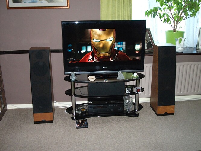

I don’t miss the centre speaker at all in my system. Years ago I fitted two in wall speakers either side of the fireplace with wiring also in situ for a future centre speaker. Also 2 ceiling rear speakers were fitted. I would have fitted an in wall centre speaker above the fireplace but I was concerned it would be damaged by the heat, so it never happened. My Cambridge CXR 120 receiver has been programmed for 4.1 and sounds great. The Ovator400s in the picture are not part of the av system.
