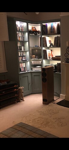

Hi Dunc, any chance of posting a photo of your set up please? ATB Peter
Hi peter its the same really as it was with the fact 12’s apart from the rossini has gone.
The facts would resonate my cabinet at a certain volume and bass, now i get better bass and no resonate, so the facts must have been doing something the 808’s aren’t
