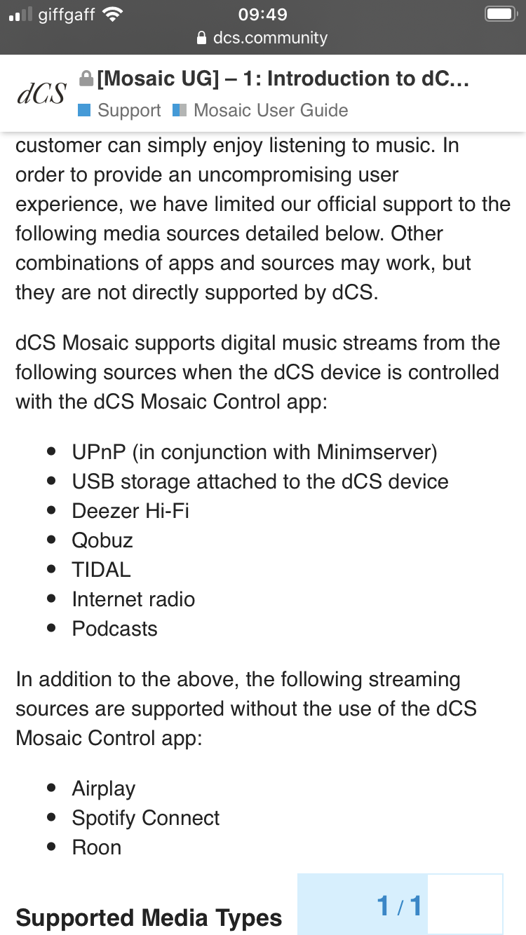

In the Mosaic user guide it says it does UPnP with Minim but doesn’t mention Asset.
Correct but they say Minim simply because they only want to go through the hassle of knowing one particular server package. It’s not to say it won’t work with other packages. In fact I had a pre-purchase conversation and they pretty much said as such.
