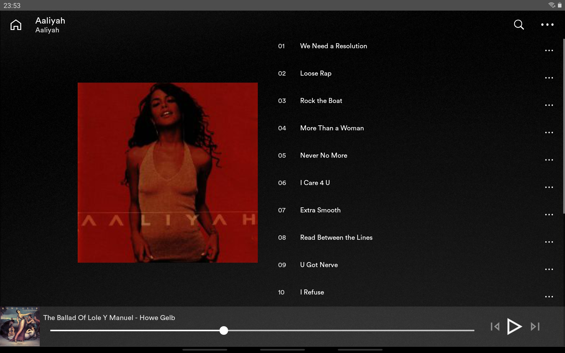

This is the screenshot from the app:

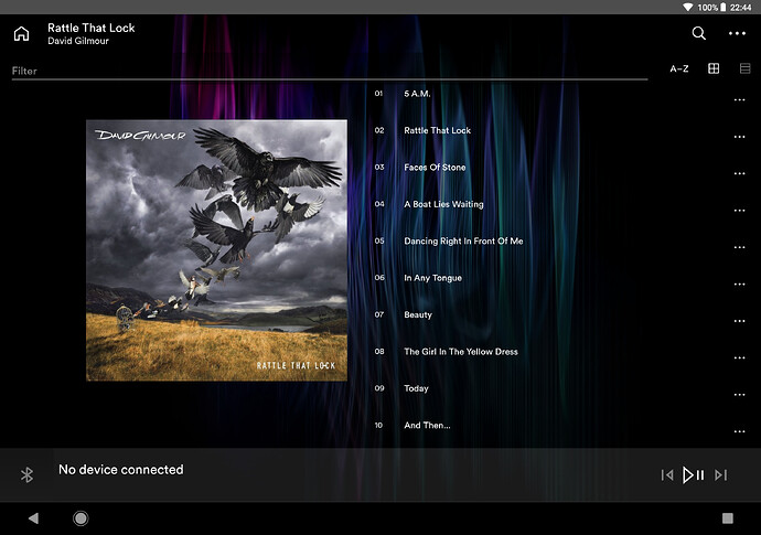

Using Asset/Naim app. you’re lucky if you’ve got album art. About 50% don’t show up in my Naim app. Although they are all visible on the SBT.
Both look OK to me. :innocent:
Aaliyah is OK in both :wink: But in the second, look at her hair getting mixed into the background, and the compression artifact of her right arm that’s running along her real arm. You need to zoom in a bit or move your head closer to the screen

Sorry that if I spend the time to rip a 1000 CDs I want the result to be good and ask the esteemed forum members for input on why it does not work. Which is clearly possible based on elverdiblanco’s screenshot above.
