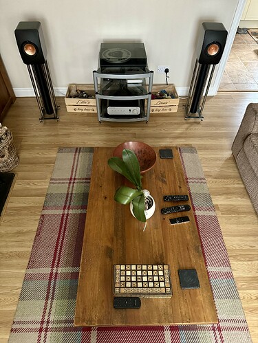

The main issue is the coffee table in the photos below. I believe the PMC’s emit bass frequencies from the bottom of the speaker cabinet and I wonder if the table, which is about 40cm high and positioned between the speakers (which are 1.7m apart) and about 1 m away from them, would likely have a greater effect on floor standers compared to stand mounters.
My listening position is at the end of the coffee table which is further from the speakers than is ideal but it is what it is. The perspective in the photo makes it look worse than reality. I’m going to demo them at the dealers but I’m not sure if I’ll be able to home demo them.
I may be thinking a load of nonsense and apologies if that is so.
It shall not have “effect” !!!
Typical bass wave length is more so no worries here
Frankly to my opinion and experience none of the discussed speakers will work to their potential with such positioning - I would suggest to look for something designed to place close to the wall
Bass is not as directional as the higher frequencies, and I doubt the coffee table will have any more significant effect on the bottom end then it will on early the top end as raised previously (may have been the other thread)
Incidentally, I note the doorway to the right. It is likely to make a significant difference to sound whether that remains an open doorway or if there is a door that is closed while listening. Door open is lightly to reduce bass, door closed increase it. (Almost a ready-made tone control! Except of course somewhat a symmetric)
@Dipper I echo @Phystech. You need speakers that are designed to be rather clever se to the wall behind them if you want optimal performance. However everything is relative. You might find the speakers you select perform well enough when close to the wall. I would also consider sealed box speakers. From my experience, it does not matter where the port is or how it works. Ports generally don’t do optimally close to a wall. All that being said, your room could have a bass drop which might balance what you would expect to be a bass rise due to wall proximity. You never know.
