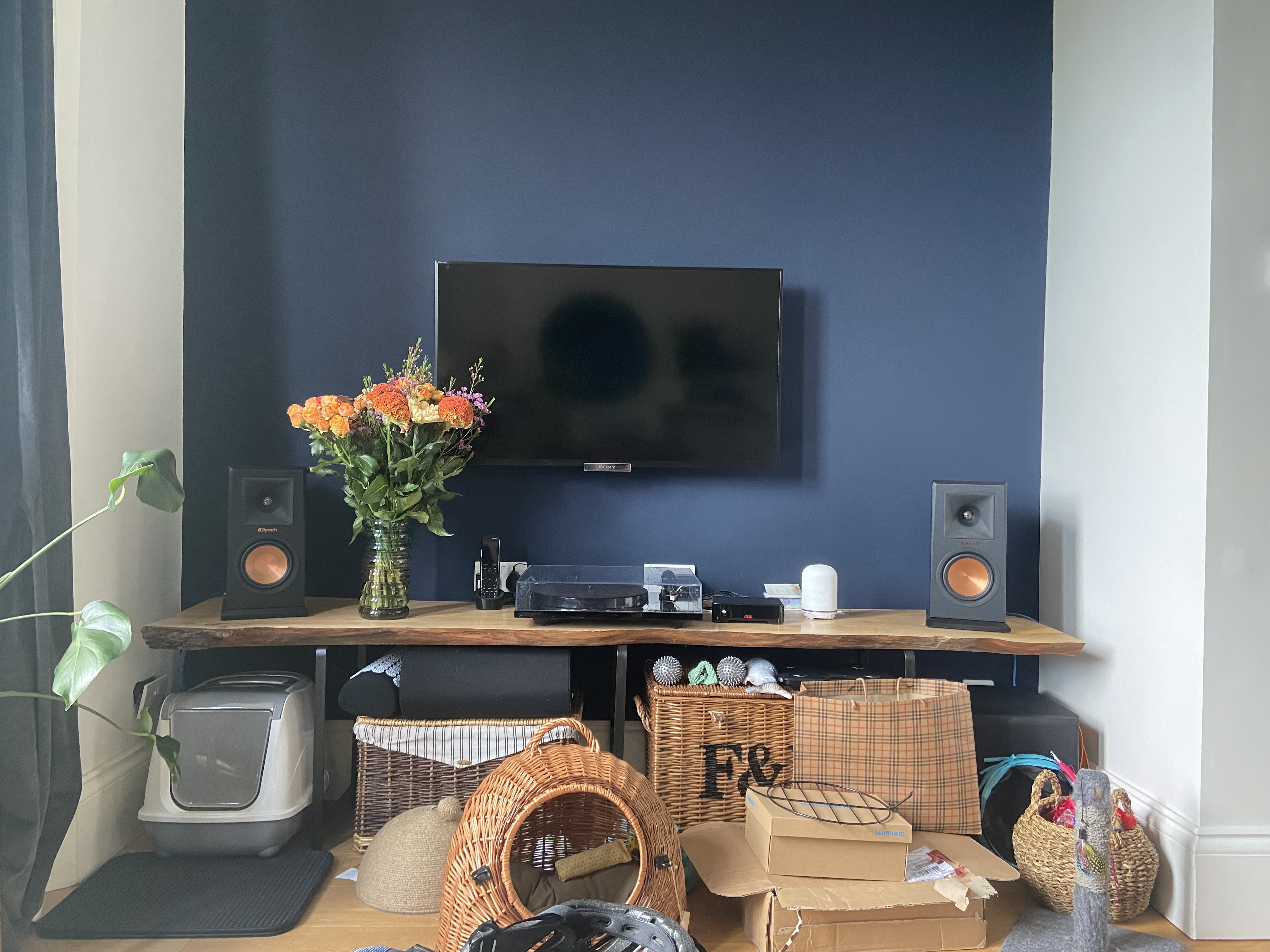

Thank you, excuse the mess but you can see the setup in the image below.

Might it be possible to saw the two ends off the shelf, say an inch outside the supports. That would enable proper stands. Having a turntable on the same shelf as speakers isn’t a good idea anyway. It could still look nice and would sound much better. Then you’d be in a position to try different speakers, or you may be so pleased with the improvement that you don’t feel the need to change. The Custom Design FS104 is a good option.
Hmmmm, everything is possible but probably won’t meet the approval of the fiance!
I might invest in some stands and try them just in front of the shelf with my current speakers as it is before cutting anything!

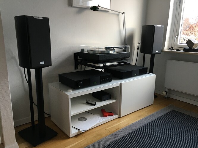

Just saw you have the turntable on the same same shelf as the speakers - not a good idea as mentioned by HH. Solution to that issue could be to put the turntable on a dedicated shelf mounted behind your main shelf with just a little clearance in height.

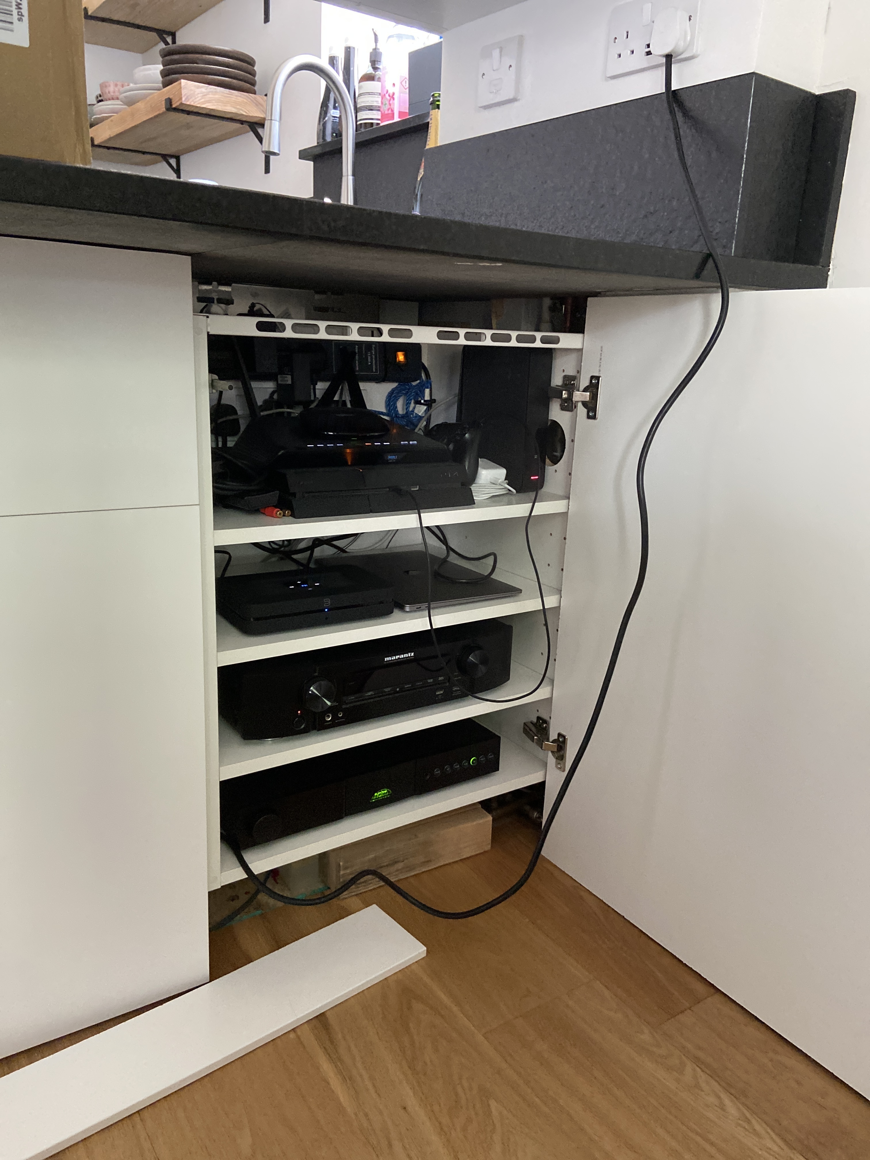

I have this alcove as well I could try and fit the TT on the top shelf. Not sure where everything else goes though! Excuse the rough lead, that was my trial grounding plug which was a success!
That location for hifi equipment worries me alot.

Sorry, forgot to attach it … Here it is:
