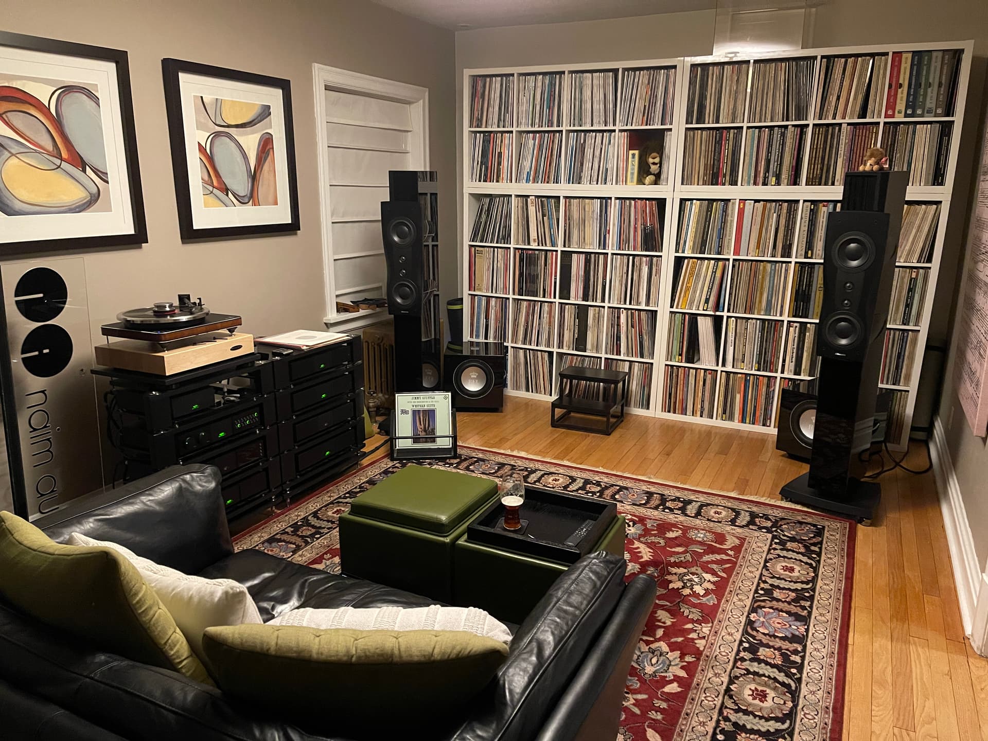

If you connect a stereo pair of subs, connecting at speaker terminals can be the difference between a 1.5m tidy cable from speaker to sub, hidden away behind them, vs 6m or even 10m cables you have to run from the amp out to the subs. If you have your system rack between the speakers then it may not make any difference. In my case it really the difference between running 10m and 1.5m cables in my room.
Looks great … AND you have beer!
Yes, and the cost of a Bassline Blue upgrade can fund an awful lot of lovely hoppy IPAs, and it’s well known that’s the superior upgrade anyway.
