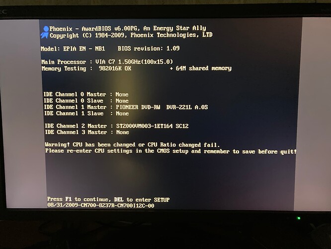

I have just replaced the CR2032 battery in my 2010 HDX for the first time. I have a PS/2 keyboard and VGA monitor. When the HDX boots, I get this screen on the VGA monitor:
I understand from other threads that I need to reset the BIOS to the Naim Defaults. It’s not clear to me whether I need to hit F1 to continue or DEL to enter SETUP.
If I press F1, the HDX boots up fine and I get the usual screen on the front of the HDX (which is mirrored on the VGA monitor). The HDX appears in the n-serve app, and on the network, and can play music.
If I gently shut down the HDX (remote control then power switch), turn it back on and instead I choose DEL, the VGA monitor goes blank, the HDX screen says “Starting…” and I can just hear the HDX drive quietly rattling away. The HDX doesn’t appear on the network. I left it overnight and in the morning the HDX still said “Starting…”, i.e. nothing seems to have happened.
In neither case do I get to a CMOS Setup Utility screen such as the blue screen shown here by @Grx8 Unitiserve SSD battery
I’m stuck- can anyone help please?

Thank you @NeilS . I tried another monitor (a TV) but with the same exact same result. BTW I’m using a VGA to HDMI adapter with supports resolutions up to 1920x1080@60Hz (1080p Full HD) including 720p, 1600x1200, 1280x1024. The original monitor was a NEC MultiSync PA272 which displays the first screen on HDX start up, but simply reports no HDMI signal as soon as I press the DEL key. Could the adapter be the problem? Regards.
Wayne
Ok, lets try to do this blind - don’t worry, the BIOS is pretty well locked down, so unlikely to do any harm if it goes wrong.
Switch the unit on with your monitor connected & press the delete key above the direction arrows when you reach the CMOS error screen you posted above.
Give it 10 seconds or so.
Using the direction arrow keys:
Press right once.
Press down three times.
Press Return.
Press the Y key.
Press return.
Direction down arrow once.
Press return twice.
Hopefully the unit should then boot up.
Then shutdown & restart.
If the unit then boots without issue, then use the Naim menu system to set the date & time.
Best of luck!
Regards
Neil.
Well played Neil! Worked a charm first time. Thanks so much!

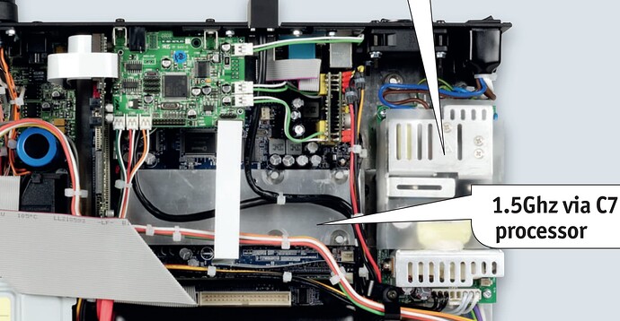

I have read, and reread these pages a number of times, looked all over the internet, Youtube, NAIM Audio, and have yet to see the schematics for the HDX! Maybe I am blind, maybe it is right in front of me, but staring at the guts, then with high brightness spot, now with photos, still don’t see the battery?
Anyone KNOW where it is please ? ( I mean should be on the motherboard, but just don’t see it. ). And i wonder, if replacing the battery, and maybe resetting the BIOS, will fix the fan issue, of the unit , which apparently many people commented on ? Anyone from NAIM knows the answer ? Thank you! (PS: HAven’t used the unit in years, because of the fan issue, then went to restart, as have my BRYSTON BDP-2 out of the rack, and unit would not start. Just got hot, but never started, hence the look to replace the CMOS. Original unit, with 500 MB drives, that I was going to replace with SSD, but got involved, testing units from LOAD). I did replace my CD/R/RW, as I saw a Samsung unit in MicroCenter in the US a few years back for $20…Thanks !
It’s a CR2032 button type battery about 7/8 inch across and 1/8 inch thick. It will be there somewhere and I never read of anyone else having a problem finding it. You will indeed have to reset the Bios. I suspect it won’t help your fan issue.

From a picture I found on the web the battery is most likely to be on the motherboard which seems to be loacated underneath a smaller board. The motherboard is the blue board in the picure below so perhaps the battery is hidden by the smaller board.
Guys, with all due respect, the battery type, size, brand isn’t the question. I personally prefer Duracell, HAVE A brand new one, as I keep on hand. ( I am in this business). My question was very specific, “Where on the motherboard and or where is the board located?” If you know, GREAT, and thank you ! (The fan issue was and or is, possibly related, as this, after all, a computer…and NOTHING is random, everything has lines of code written, somewhere in the OS. That aside, location please? )
