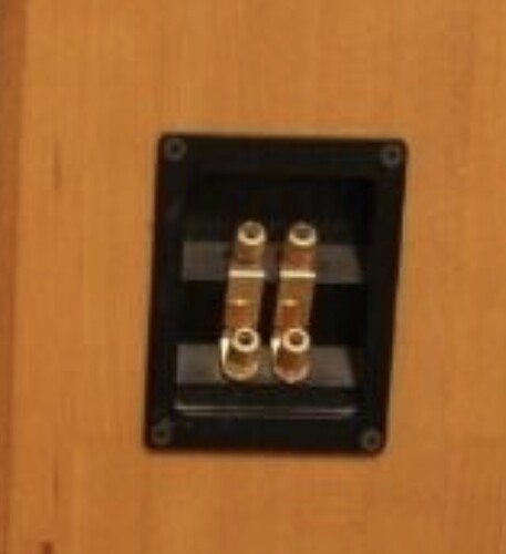

Thanks for the various advice on wiring. This is the way I have connected. In principle, it must be the same as connecting four sockets. I have then made a diagonal crossover. This is what I’m experimenting with to see if there should be a difference in the sound
Photo of my F-Connection with Naca5 cabling for reference:

That’s the way enjoy and forget. :+1:t2:
