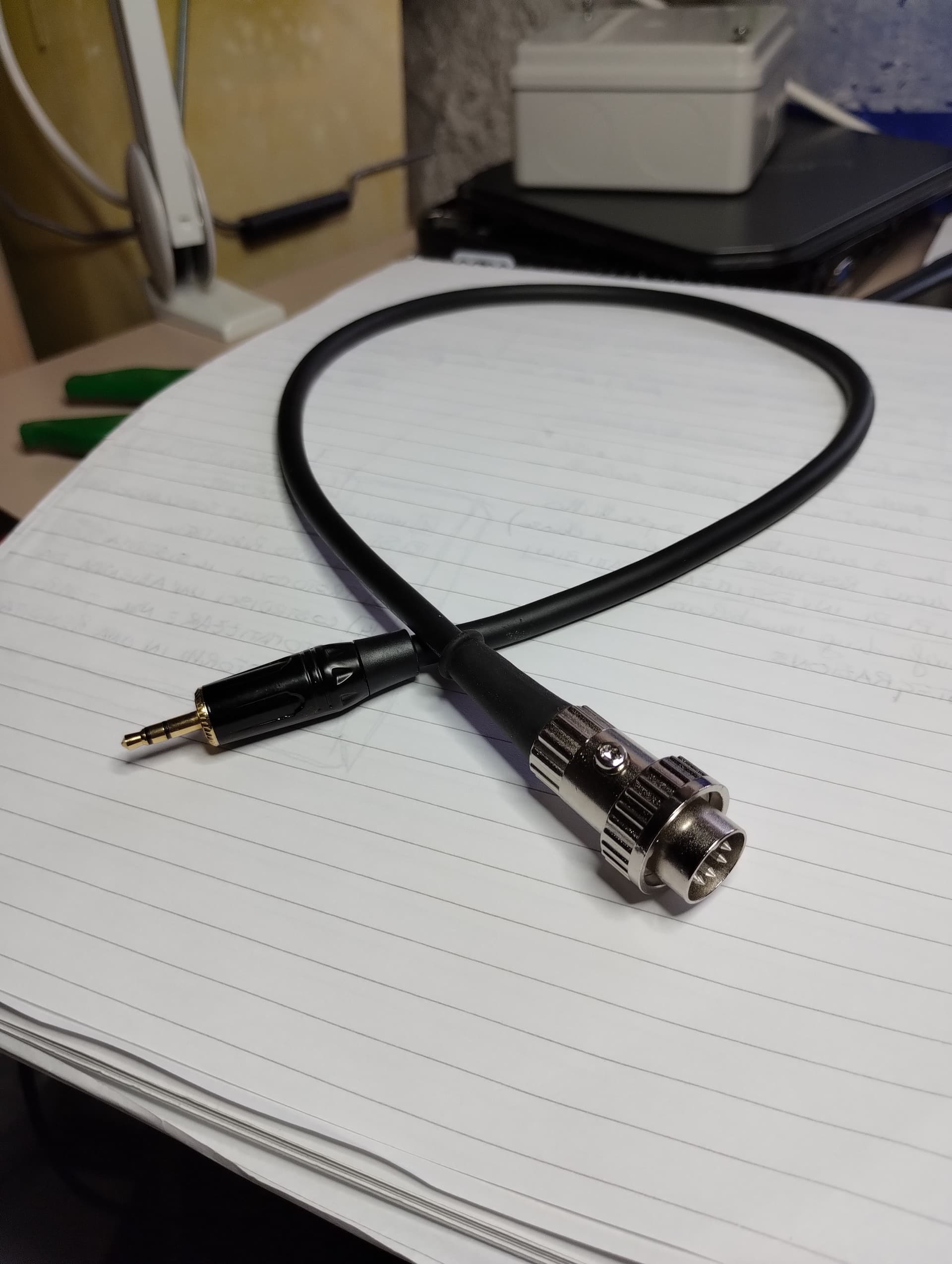

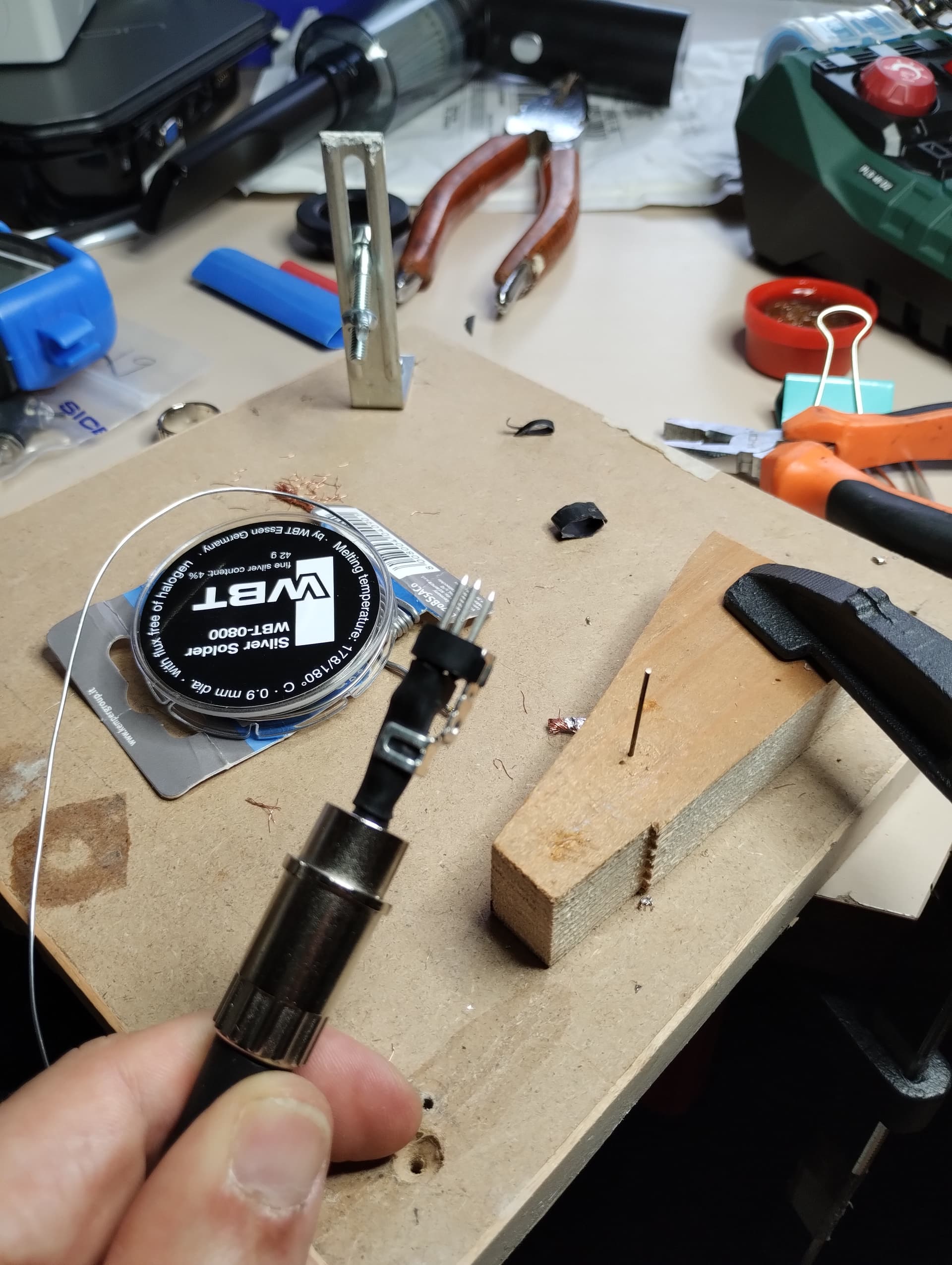

Result of an afternoon of work. It’s not my first self-made cable but soldering a din connector is different than an RCA. a real challenge, I am very satisfied. thank you in the community for the support.
