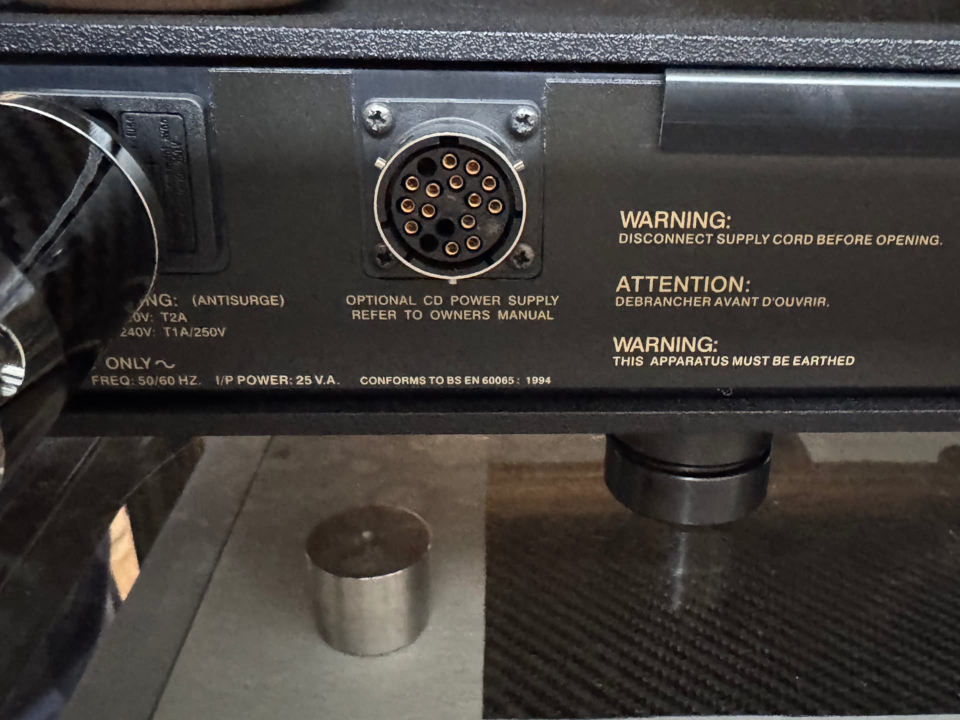

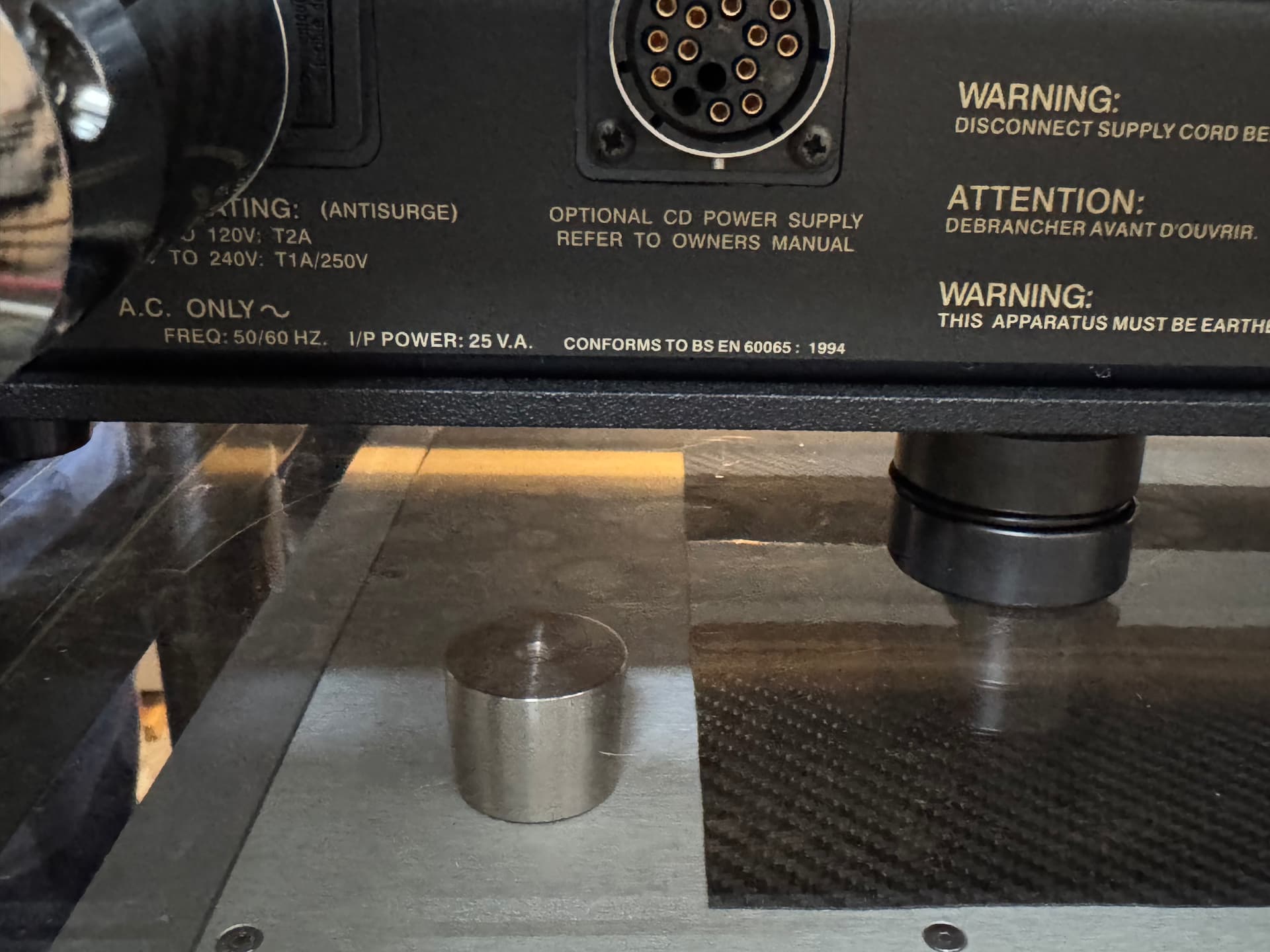

Hi Richard Thank you for all the info. Very helpful. My CDX appears to have 3 extra pins on them. Do I need to take that into consideration?
better photo
It’s fine. some of the pin sockets are for the link plug connection. All you need is a genuine XPS or S-XPS Burndy cable.
