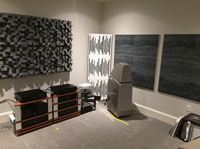

I can assure you from extensive personal experience with both brands that a NAP 500 not only drives the Wilson Sasha DAW well, it is one of those magical combinations that fosters a “whole is more than the sum of it’s parts” listening experience. For most listeners, any of the Naim amps from a 250 on up in the Naim line up work well with modern Wilson speakers. I recently went to a customer’s home with a ND 555, a NAC 552, and a NAP 300 DR feeding his pair of Wilson Sasha DAW’s to fine tune the Wilson speaker placement and optimize his system. It was among the very finest Naim systems I have ever enjoyed in the many decades since I was first introduced to Naim in the neolithic era. Naim and Wilson both prioritize dynamic tracking and timing. The two brands can work beautifully together in this era, which was not always the case with older Naim amps when partnered with some of the Wilson’s from the previous decades. As always, you should try to hear this for yourself. Even the best speakers won’t be to every listener’s tastes.
