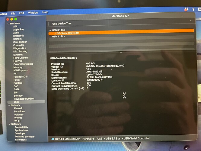

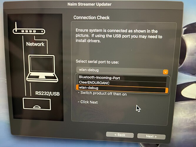

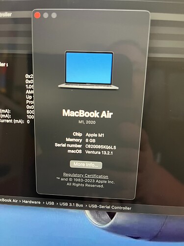

OK. I’ve now got a RS232 to USB C cable. I’ve downloaded and installed the driver, but on the updater, the cable isn’t showing:
Can someone explain why it’s not showing?
