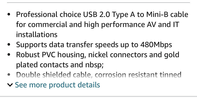

The one I used was made by Lindy. Iâve looked on Amazon and think this is the right one. Itâs ÂŁ2.28.
We arenât allowed to link to commercial sites here. But if you go to Amazon and search for USB A to USB mini b then you see lots of choice. It doesnât matter whether itâs USB 2.0 or not but if it says USB 2.0 its fine. (The A and mini b refer to the size of the plugs whereas 2.0 refers to the data transfer speed.)
Donât buy one that mentions camera charging unless it also says â and data transferâ. There is no advantage in buying a more expensive one, so go for a cheap one.
Edit: HHâs post above does indeed show a suitable one.
Thank you
You are most welcome. These wires can be a minefield, with all sorts available. That one should be fine.
