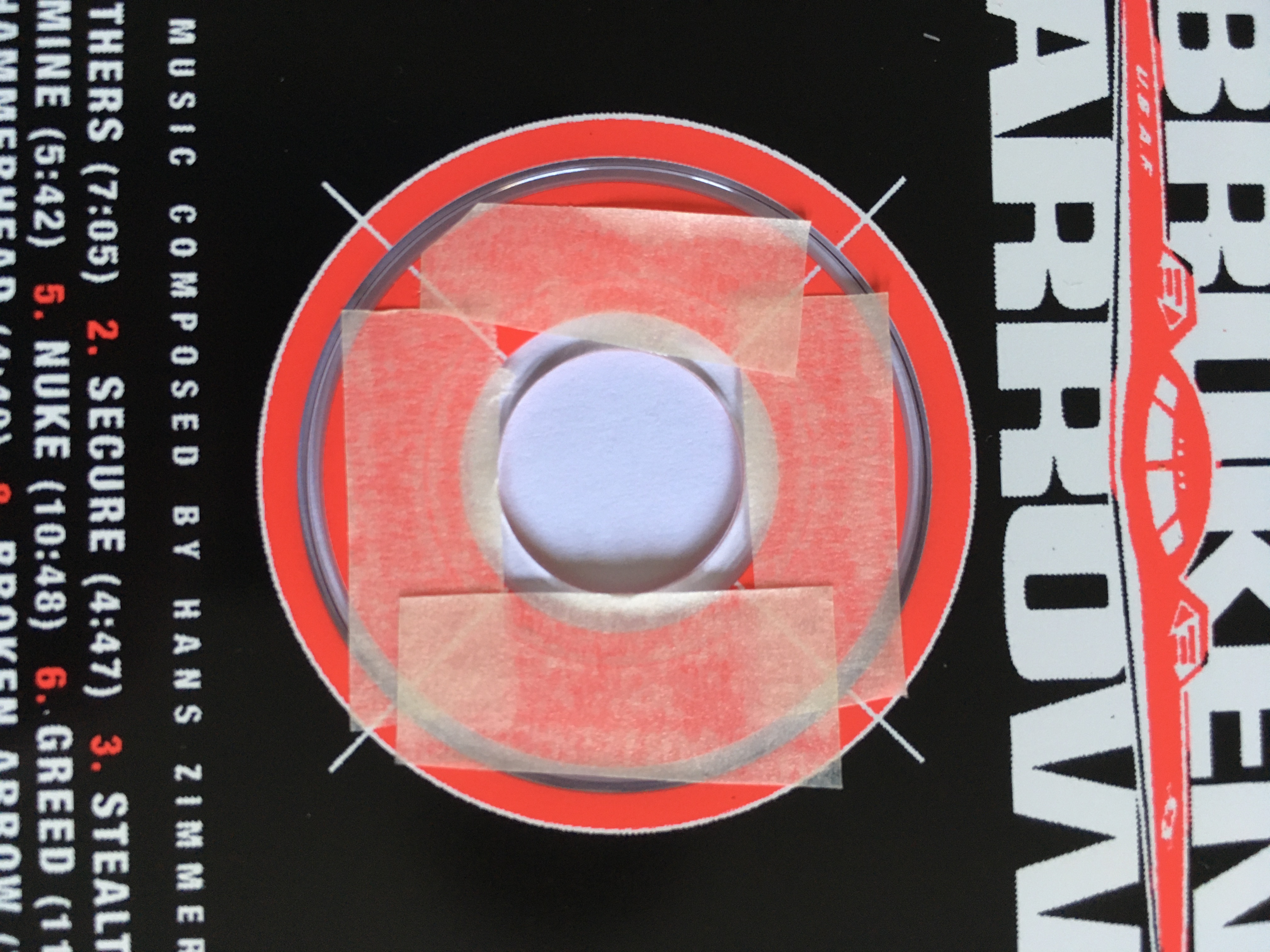

Also what I read on the interweb, is that some CDs are apparently thinner than “red book standard” and that you can stick some sellotape around the hole, which “thickens” the contact area between CD & puck.
Yeah….so my initial thoughts were “load of b******s”; that is until I tried it. My wife’s CD3.5 is still in use!

Not tried blu tak, but i found that sellotape worked on the half-dozen CDs that were giving problems.

Here a description and picture of the masking tape solution I posted a while back:
Apart from once needing two layers of tape, I’ve never had this solution not work for any CDs which give the dreaded ERR on my CDX2.

Still, the suggestion for thickening thin CDs is worth a try.
Ditto, two different pucks couldn’t cope with some very thin disc centres.
