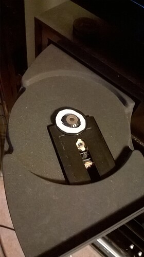

I would occasionally get some ERR messages on my CDX, so I cut a little circular ring out of paper as shown below and it did the trick!

It’s fine, although you’re probably better of sticking the paper circle to the discs that have been pressed thinner than redbook, otherwise it will not be optimal for all the other discs pressed top the correct red book standard.
Alternatively get a Clamp 5 and then use it for any problem discs and just be very careful when placing it or removing it from the spindle as it will stick like a limpet.

I’ll try citting a paper circle. I wonder if this issue is unique to the 3.5. It seems like if this is a known issue Naim would have offered some support to work around the issue.

Clamp 5 rather than clamp 3 for 3.5?
The Clamp 3 is the correct one for a CD3.5. However, if you’re trying to play a CD that is outside of red book standard and pressed too thin around the centre, and you’re either getting skipping or ERR at the start, then using a Clamp 5 can usually help. I can’t recommend you use it all the time though as the extra magnetic force of two magnets (one on the hub, one in the clamp) can eventually tear the magnets out of their housings.
The only thing I find odd about this is that it’s always suggested that problem discs have been pressed too thin rather than too thick. Given that my ERR discs sound very much like they’re not being gripped hard enough and slipping, that suggests to me the discs are too thick, making the magnets too far apart and, therefore, attracting less strongly and leading to slipping.
So what aren’t I appreciating here?
