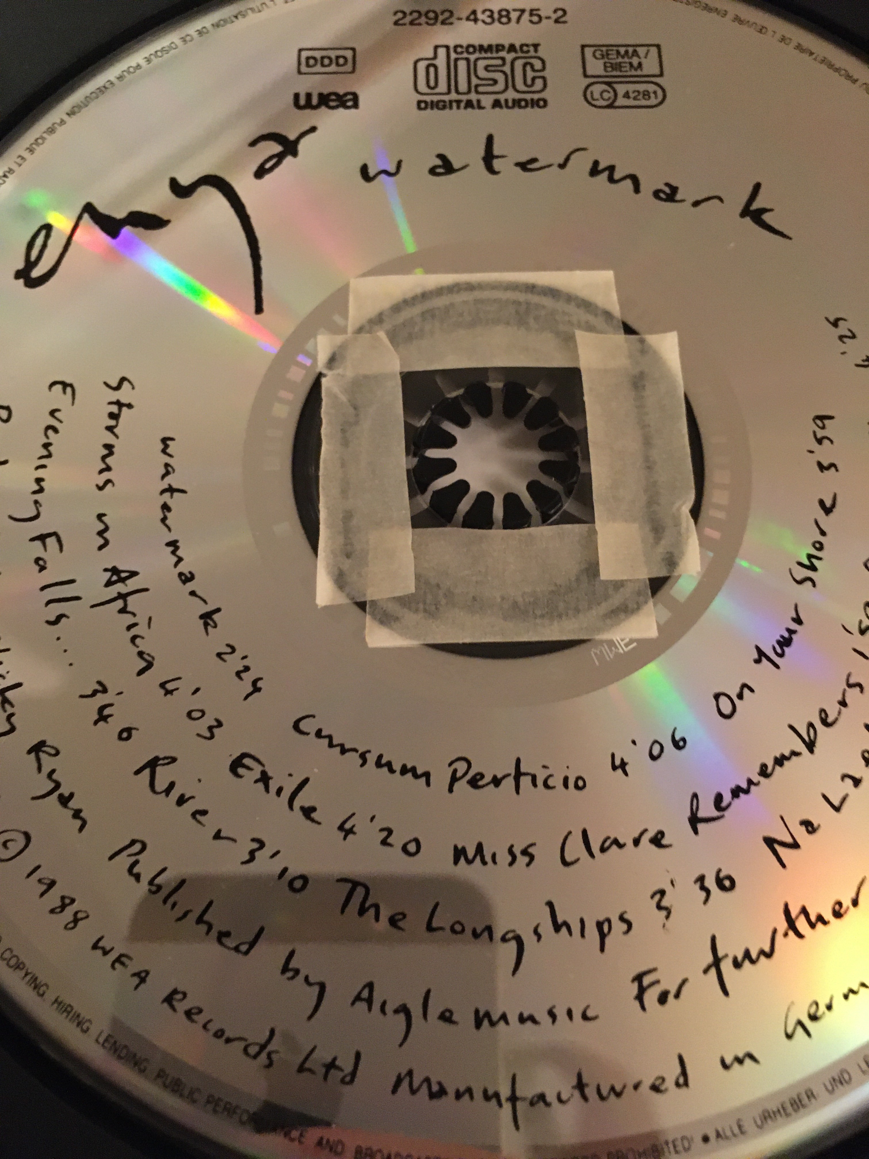

My CDX2 still has its original mech & clamp and occasionally refuses to play some slightly out-of-spec discs - they slip when reading the TOC and the display just says Err.
The solution (as recommended by a well-respected Naim dealer) is to put strips of masking tape around the central hole to improve the grip:
Might be worth trying this with discs that don’t sound their best - it’s one of the cheapest tweaks you’ll ever try, and it might just work.

When it comes to albums that, like Watermark, have been around for a while, there will be many different pressings made at different times in different countries and they therefore won’t be identical. So, just because your copy of Watermark plays perfectly on your transport but doesn’t on my (theoretically identical) transport, it doesn’t automatically mean one transport’s at fault - the two discs could have been made on different machines to different tolerances in different countries in separate decades!
