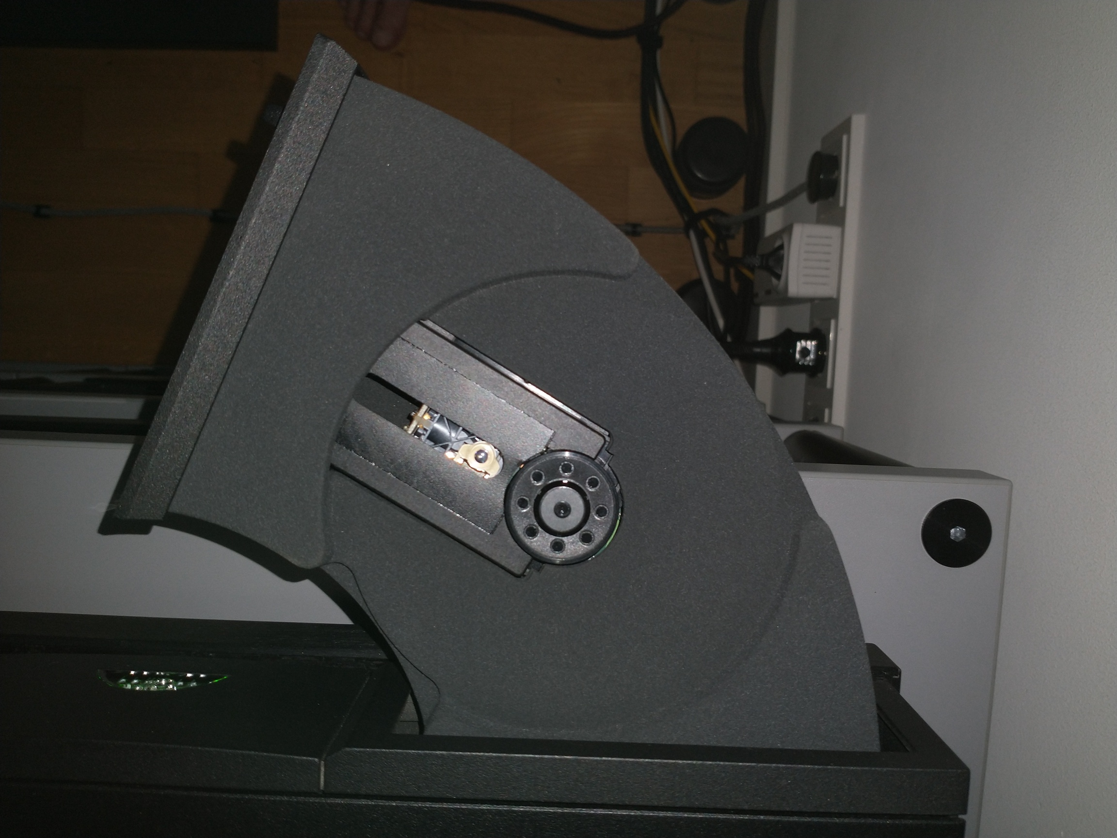

I had a similar problem with a CDS2 when the suspension became misaligned.
It was rectified by inserting the transit screws (which lifts the mech off the suspension), then removing the screws slowly, at the same time, keeping the mech level, which will reseat the mech on the suspension.

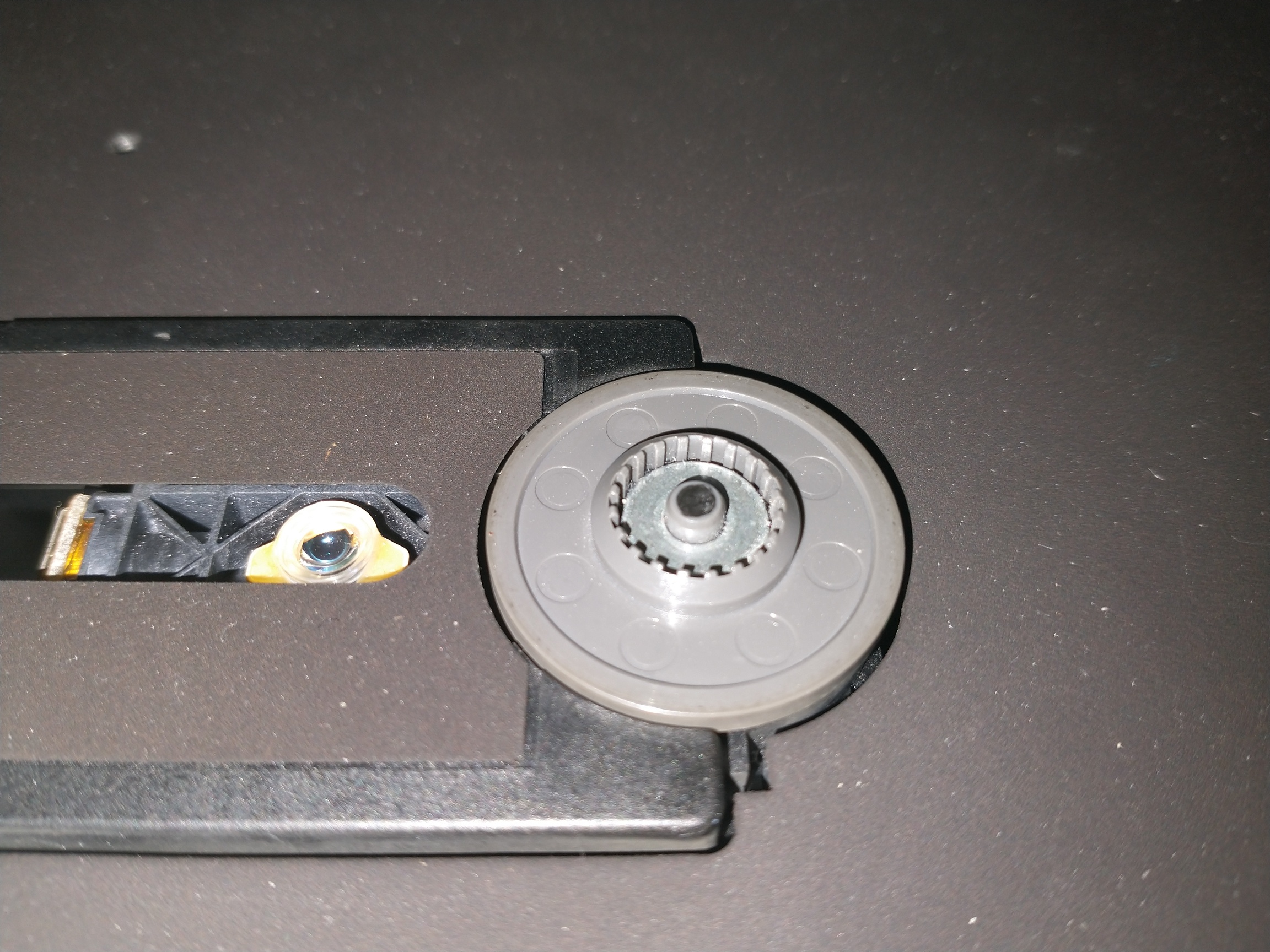

I would have a close look at the transport platter for a hairline crack across the radius. A crack will open the diameter of the spindle hole & allow it to slip.

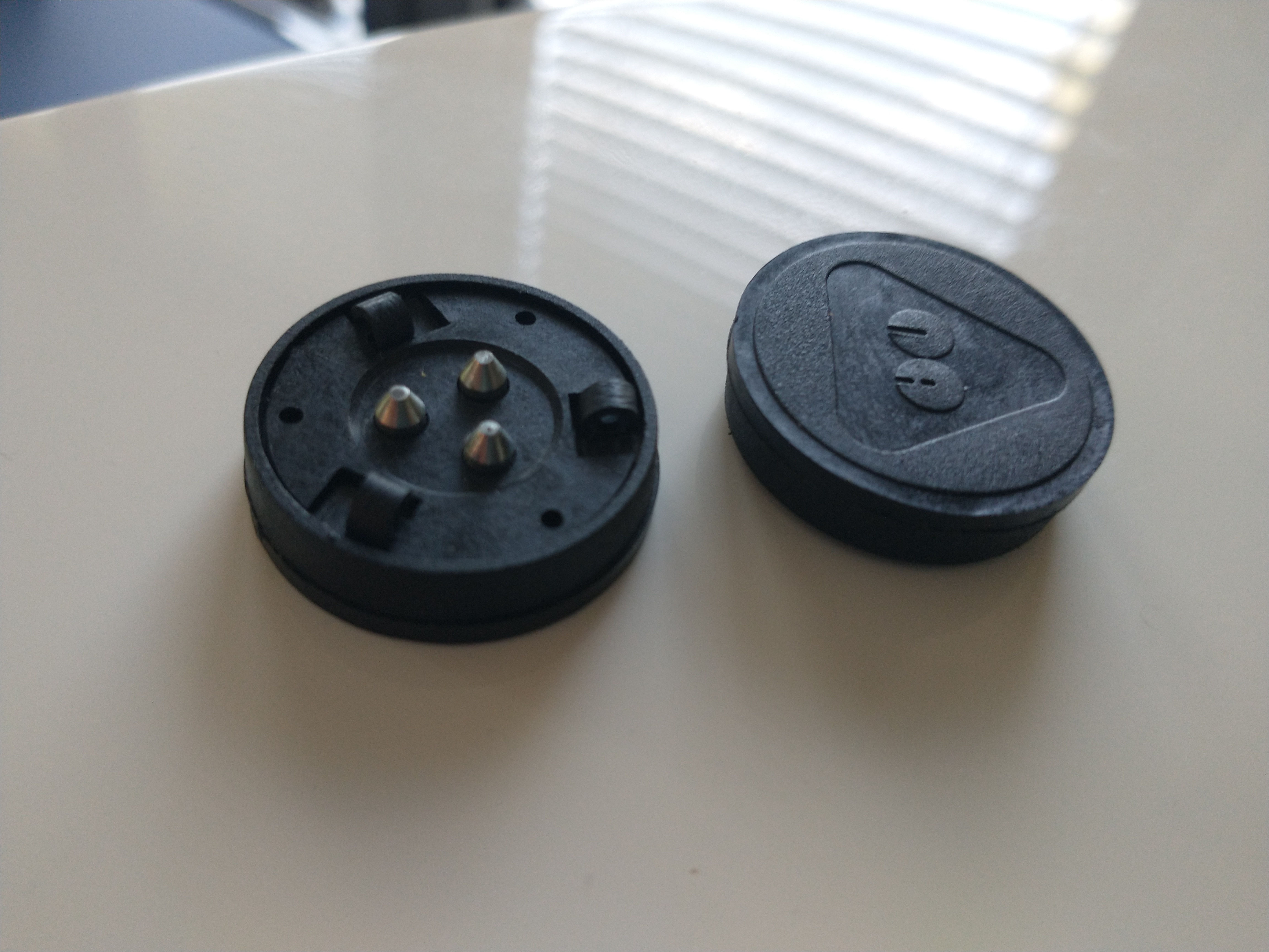

I’ve found with my CD3.5 the three small rubber rings in the puck compress. Get a pair of tweezers and rotate these round a quarter turn. If you have it, also give the rubber a wipe with some iso-propyl alcohol to clean the surface.
Longer term, I don’t leave a CD in the player and I rest the puck on a shelf when not in use so the rubber recovers from the compression - I don’t leave it on the drive mechanism.

I had the CD platter hairline crack issue on my CDX2.2 from 2016. This is obviously a problem and so bought a relatively expensive Chinese mech and pulled off the platter. I put this platter onto the spindle and all is now well. Perhaps Naim could commission a new platter?
