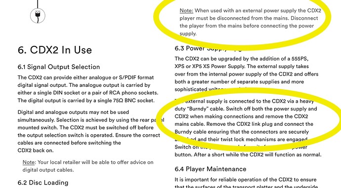

The manual explains:
Note: When used with an external power supply the CDX2 player must be disconnected from the mains. Disconnect the player from the mains before connecting the power supply.

wow, never thought of that. The note written between the gear illustration “if using a XPS 555” told me “well, I do not have that” and I find that that is completely misleading and irritating that there is a 2nd note telling all XPS external supplies…makes no sense at all for me! But thankks, I will have a word with Naimgermany and my seller about that.
This is an extract from the manual. It couldn’t be more clear.

Hello. Thanks. Yes english is not my first language, never was really good at it. I suppose I read it in german 10 years ago when I got the CDX2 XS, but suppose that also in german it could be ambiguous. For me also now it is of no sense in seperating note 1 focussing on XPS 555 as it would be very special compared to Note 1 for all the other XPS. Secondly: one could interpretate that before “When you use your CDX2 with an external power supply (XPS2), you have to not insert at all your power cable into the CDX2 as the XPS2 delivers the current for both XPS2 and CDX2” must be disconnected from the mains could mean for the moment of installation, and then afterwards you can put the power cable back in. Disconnect the player from the mains before connecting the power supply repeats exactly the same but again does not say clearly that it is not just the order of connecting the power cables. So it could mean: "First you connect the power supply main power cable, and then afterwards you connect your CDX2 to the main. In the second yellow, they could at least emphasize by bold “…and remove the CDX2 mains cable” and here is written “while making connections” So this could mean that only for the moment of connecting you remove the CDX2 main cable. Removin does not mean to NOT PUT IT BACK EVER… what a ambiguous sh… well not better at all, even worse. What’s the power supply output socket 1 ? Only thing where I could have thought about this would be the fact that manual tells me to switch on the power supply but not the CDX2. Well, they sould have written it in bold and not only put “Note” but “IMPORTANT NOTE” Not happy aboput this and thanks for the RTFM , dear Mtuttleb. @anon4489532: many thanks, I suppose many other Naimies did it wrong and do not wanna discuss about it anymore :slight_smile: But my initial problem is solved as there only remains 1 socket, hope my fuse will not blow now. Greetings from Luxembourg, a country with its own official language :slight_smile:
