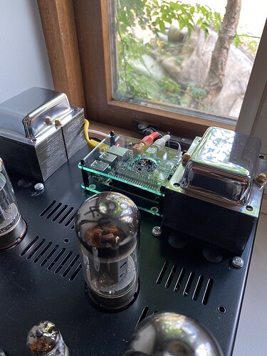

I use the RaspberryPi/HiFiBerry solution in multiple rooms. Have used the digi+ into a NAC-N 272 for awhile. I have two non-naim systems in the office and basement and have recently upgraded my Pi hardware and am using the HiFiBerry Dac2 HD https://www.hifiberry.com/blog/hifiberry-announces-the-dac2-hd/ it is a huge upgrade and a great dac for the money and a great dac overall. So quiet and so detailed it is really a good source period. It also has good isolation and they don’t recommend the use of any kind of more expensive power supplies, the RaspberryPi USB-C psu is just fine… I can’t recommend it enough. I use Volumio which is also terrific and can’t recommend enough…
These are my RPi setups:
Lounge: RPi 4B/HiFiBerry DAC2 Pro/HiFiBerryOS → Aune X7s headphone amp/Sennheiser HD650
Study: RPi 3B/HiFiBerry Digi+ Pro/HiFiBerryOS → Micromega MyDac/B&W MM-1
Bedroom: RPi 4/RoPieeeOS → Audioquest Dragonfly Red/Sony noise cancelling headphones (doubles for mobile use)
Conservatory: RPi 3B/HiFiBerry DAC+ Pro/HiFiBerryOS → B&W MM-1
Couldn’t be happier.
I have noted HiFiBerry’s comments on power supplies but using ifi xPower in the Lounge headphone and Study setups.
Dave

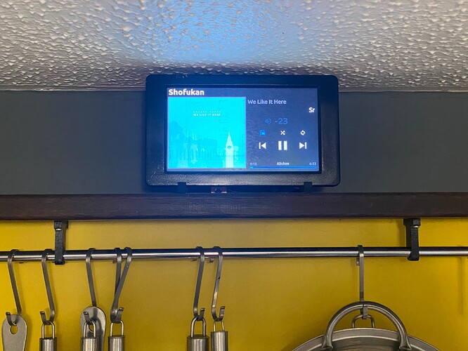

If you want something a bit tastier then the same pi can have a pi scree 7 inch attached to it to display whats playing and this software is all handled by Ropiee.
Here is a very bad shot of one such set up in my kitchen.
Cases for all of this area available on amazon and for like 120 quid you have an excellent roon endpoint with display for your qutest. win win in my book.
