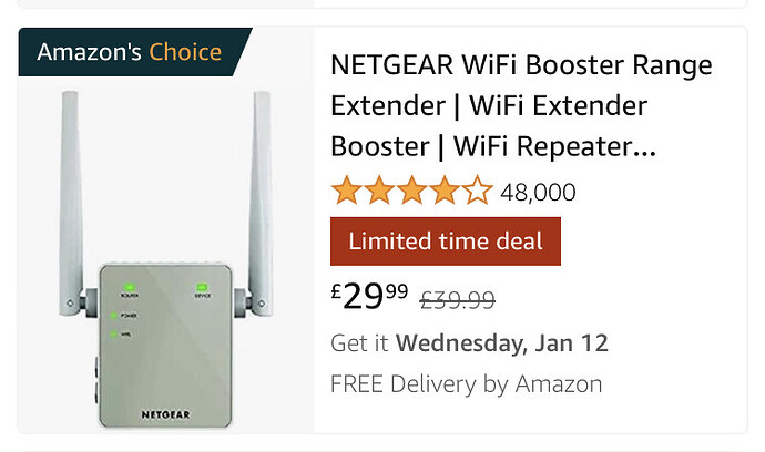

If I remember correctly, you had something made by vonets. An alternative would be this from netgear, search Amazon for “AC1200 (EX6120)”. This one plugs direct into the socket but you can always use a mains extension cable to site it somewhere less conspicuous.

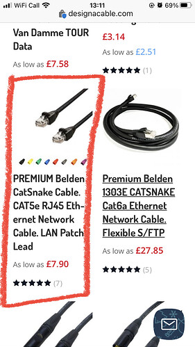

For an Ethernet cable, look at designacable website and their “catsnake”.

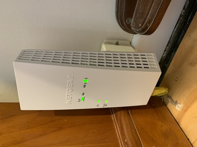

For my Uniti2 I use a Netgear wi-fi extender that has an Ethernet output. Plug the Netgear into a power point, connect to wi-fi and run the Ethernet cable to the Uniti2:

Interesting that we now have two votes for Netgear. Duly noted. @Mike_S is that thing huge or was that just a perspective issue?
It’s 160mm high by 80mm across, so not tiny. The photo is rotated by 90° for some reason. I use it as a workaround on the flaky Wi-Fi on the Uniti2.

I suppose the question to Netgear owners then is why that specific device and not another?

Rhinocables Ethernet RJ45 Extension Cable CAT5e/CAT6 Network Internet Extender — Male to Female Patch Cord Connector — 5m / 500cm, CAT5e (Grey) from Amazon.
I think they’re right. Thoughts? Struggled to see an equivalent on designacable so have persuaded Mrs. H. to press buy the cat 5e on her account.
