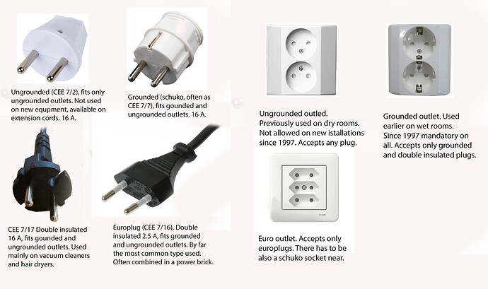

I can add that my house and all houses built up to 1994 in Sweden have non grounded outlets in all rooms except bathroom and kitchen. Not sure how that is in UK. But as always it’s the customer doing wrong when using Naim even though it’s only with Naim I’ve had buzzing transformers, ground loop issues etc. Strange.
I think Sweden and Japan are alone in the world for non grounded outlets.

Well a grounded outlet is more safe but if that statement would be true homes in Sweden and japan would be empty of electrical equipment which is not the case. Many professional studios here are also non grounded and you can and are allowed to connect grounded equipment to non grounded outlets but not the other way around and never mix grounded and non grounded outlets in the same room.

Assuming whole EU except UK has it like this? Maybe Naim is not allowed selling outside UK then :wink:
This in Finland but similar in whole EU I believe.

You will find UK electrical wiring safety standards and legal requirements along with other EU countries are aligned with international standard IEC 60364 and the European CENELEC harmonisation documents.
There are apparently some local exceptions.. I have no idea whether Sweden has compliance exceptions outside IEC 60364.. though your description suggests they do, albeit as described could lead to some very un safe environments.
