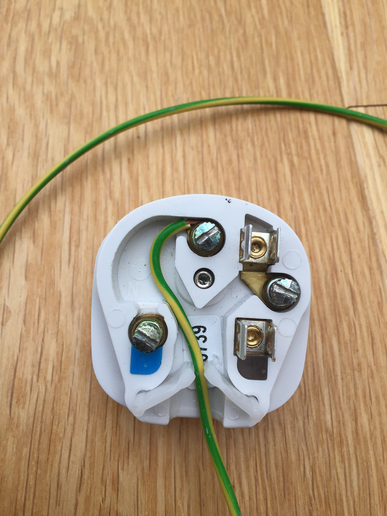

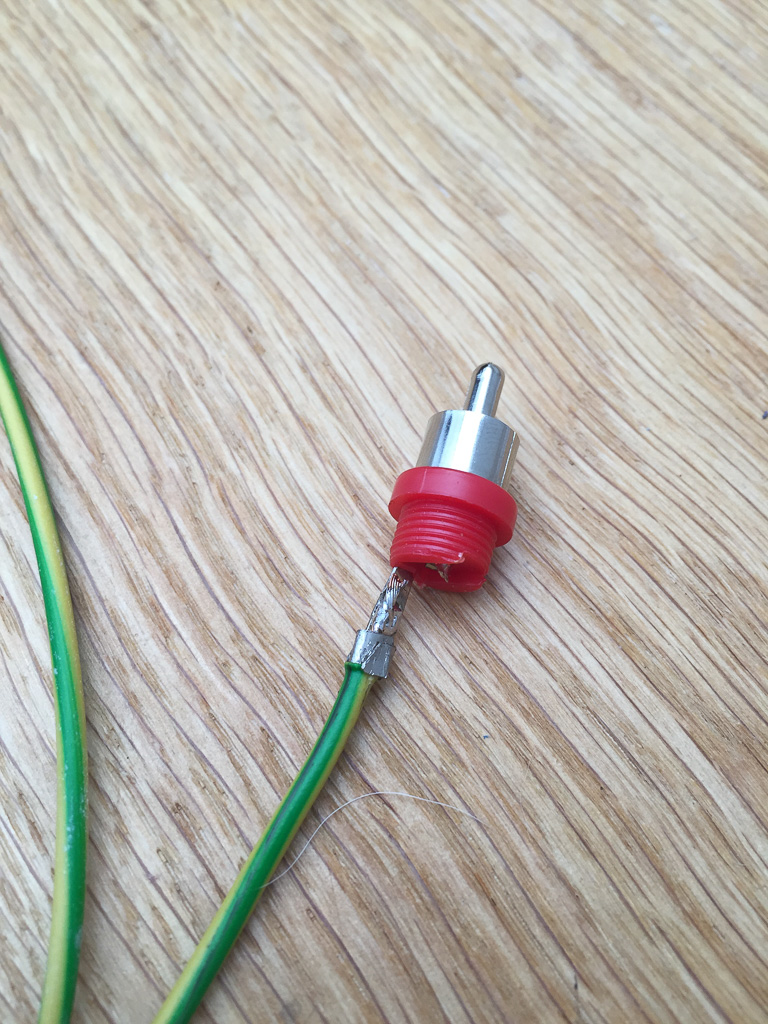

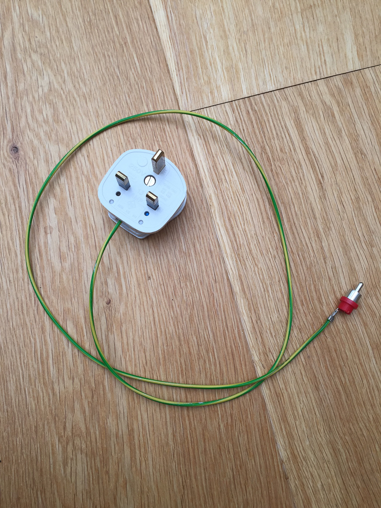

Can you find an earth binding post on the back if the pre amp? Connect a wire to this and, if you’re in the UK, touch it to the screw holding a wall socket to its backing box and listen for the hum, if it goes away you can than look to arrange a more permanent connection. I’d use the earth pin of a plug but I’d be very certain there’s no possibility of contact with live or neutral.
Never needed to do this myself, but I wonder if @james_n suggestion here would help:

@Blackbird you needed a grounded coax digital lead. Many on the market. I used an Audiotechnica one in the past and the interconnect had an earth dongle at on end to affix to the chassis earth of any supporting unit.
I suspect your issue was a combination of not knowing the requirements of the Onkyo and wrong cable.
